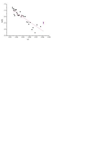

Hi,guys.
I m trying to determine activation energy of donor levels .
So i have measured absorption at different temperatures of my sample (mono-crystal)
And I have plotted ln(optical density) vs 1/T(K).
And I want to calculate activation energy useing
D=D0exp(-Ea/kT)
In plot above (picture) Eactivation should be 0.043eV
The problem is that I can't get the right answer.
Could someone help me,and derive the mentioned formula above for Ea determination? Maybe I am doing it wrong.
Hi prehisto,
First the scatter in your data should make a large error bar. What is the 95% confidence range of this fitted activation energy?
Second, I would check things like natural log v.s. decimal log and the units of Boltzmann constant, just the basic stuff.
I agree, it makes a large error bar. But in this case it does not matter . This is an example for which i know the result ( for this particular liner fitting).
i have checked logarithms and Boltzman const.
Is this the correct formula?
