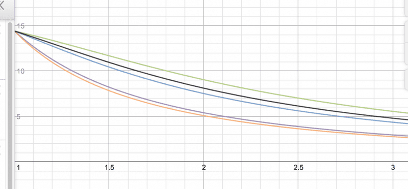

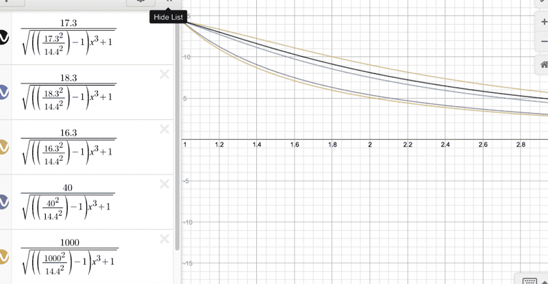

I won't try to directly address your question. Wabbit gave links to sources. I want to just start out with a little intuition about how redshift-distance data determines the estimate of Λ
https://www.physicsforums.com/threa...iverse-from-observations.814700/#post-5122799
Each choice of Λ corresponds to a different asymptotic (long-term) distance growth rate H$$H_\infty = \sqrt{\Lambda/3}$$Each of the color-coded choices for H generates a different curve (green, black, blue, purple, orange)
For a given redshift z, the predicted distance to a supernova with redshift z is the area under the curve out to z+1 on the x-axis.
The orange curve, is essentially for ZERO COSMOLOGICAL CONSTANT. It is for an asymptotic growth rate of 1/1000 ppb per year, which is negligible compared with the others. It is the lowest curve, and so it gives the smallest distance predictions for any given redshift.
I have plotted 5 possibilities:
green 1/16.3 ppb per year
black 1/17.3 ppb per year
blue 1/18.3 ppb per year
purple 1/40 ppb per year
orange 1/1000 ppb per year
When you get down to 1/50, 1/60, etc the curves all tend to pile up. They coincide visually with the 1/1000 curve. For practical purposes that can represent the limit of zero Λ.
The best fit is 1/17.3 , the black curve. You can see what it predicts for example for redshift 0.8.
That would be the area under the curve from 1 to 1.8 as it slopes down from 14.4 to 9.
That is easy to estimate: .8*23.4/2 = 9.36 lightyears now to a supernova we are seeing at z=0.8.
The green curve slopes down from 14.4 to 10, so it predicts .8*24.4/2 = 9.76 lightyears now to that same supernova.
Between the green and blue curves (1/16.3 and 1/18.6) seems like a reasonable uncertainty and by comparison the zero cosmological curvature constant, or the 1/1000 option seems way off. It would give distance predictions that are way too low. Less than .8*(14.4+6)/2 = .8*20.4/2 = 8.16 light years in the example.
