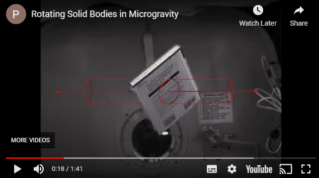

anuttarasammyak said:
Yes. The book in this video, 0:17s - 0:28s, appears to be rotating about two axes simultaneously.
I'm not sure if that is an objective phenomenon, or if it only seems to be rotating about two axes because the shape of the book strongly implies three very un-arbitrary axes to our brains, and therefore it we track two axes.
So, does a single (albeit oblique) axis of rotation exist for this book?
(I think it does. I think it's here:)

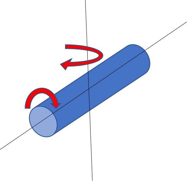

I'm not understanding something, is this following scenario not considered rotation about two axis at once?
  • Love
Likes Delta2, OmCheeto and DaveC426913
If we combine a rotation of angular frequency ##w_x## about the x-axis and ##w_z## about the z-axis, then we have a rotation about the axis ##(w_x, 0, w_z)##, with magnitude ##\sqrt{w_x^2 + w_z^2}##.
In other words, the continuous rotations add like vectors.

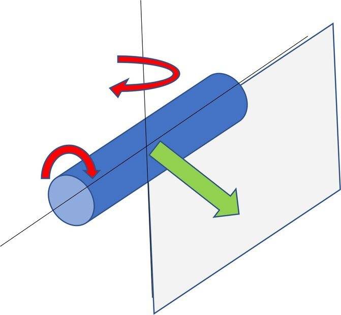

I get the mathematics, but I still don't "see it"
The rotation for the diagram I shown has a magnitude of the vector in the shaded plane, and is rotating about an axis through the origin in the direction of the vector. My brain is refusing to cooperate in understanding this.

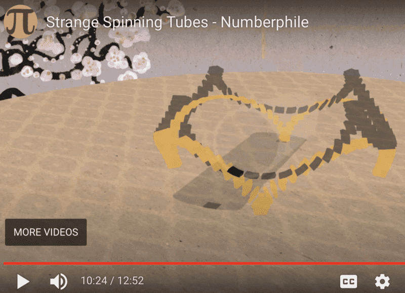

  • #34
OmCheeto said:
I'm with you and Dave on this one. It sounds like everyone else is saying the two circular rotations add up to a new circular rotation for any given point on the object. But it's shown in the video you posted (#10) that the points are not following a simple circular paths.
There is an external torque on the object in that video, so its angular momentum is not constant. As explained in post #18, rotation is the special case where the angular momentum is constant - or, at least, the axis of rotation is constant. The video shows an example of the more general motion where the instantaneous axis of rotation is changing with time.
In this case the applied torque changes its direction as the contact point moves around the circle.
In this respect, pure rotation is the equivalent of linear motion for Newton's first law. If you apply an external force, then an object may move in a curved path. And, if you apply a torque, then you may lose the pure rotational motion.

I don't understand any of it. Perhaps PF needs a level below "B" as apparently even high school maths is WAY over my head.

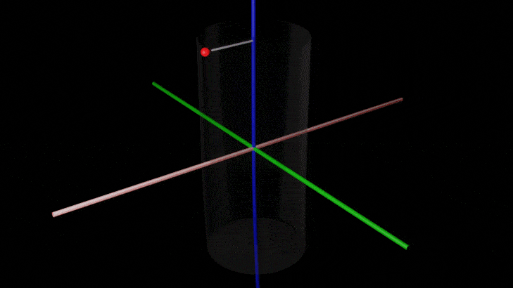

Anyone seen @Janus lately? I'd like him to render the dual axis spinning cylinder as it would work on the ISS. Clear, with just a single point being traced out.
I found a youtube video of a sphere with dual rotation, but it was solid with flowers, and my brain couldn't handle whether or not each point was actually traveling in a circle.
  • #43
DaveC426913 said:
Presumably, the calcs are describing a real world scenario, yes? That real world scenario must be fairly easy to describe. For example: to the question of does any solid rotating body always have a single axis of rotation, presumably there's a yes/no.
The answer is yes. There are no cases where this is not so.
The rotation of a rigid object relative to any other frame of reference can always be completely described with a single angular velocity vector which, in general, vary over time both in direction and magnitude. This include both cases where the object is rotating freely in space with net external torque being zero or when it is constrained to rotate following multiple axis as shown in some of the video and thus experience a non-zero torque.
For example, if an object rotates due to be put into a device that has two axis of rotation, one "inside" or "after" the other, where the rotational speed around each of those two axes is simply set constant, then even as this can be seen as a "rotation around two axes" it can completely equivalently be model as a rotation around a single axis. When using rotation matrices to describe "individual" rotation then the effective rotation is found simply by matrix multiplication. If we first rotate around, say, the x-axis ##R_x(t)## and inside this (i.e. intrinsically) rotate around what was originally the y-axis ##R_{y'}(t)## then this combine into the effective rotation of ##R(t) = R_{y'}(t) R_x(t)##. Another example of "combining rotation around multiple axes" would be Euler angles, where a sequence of three angles each with an implied axis to rotate around is used to model any orientation of an object.
That said, rotations in 3 dimension are indeed a fair bit complex with a lot of detail rich formalism and no one should expect they can intuitively understand the complexities of such rotations based on, say, their experience with 2D rotations or linear translatory motion.
Okay, it took me a bit to work out a good way to to do it, and here's what I came up with.
I did two animations, as there are different ways to treat "rotating on two axis"
Both start from here:
A transparent cylinder(so nothing gets hidden during the rotations. A red sphere on the wall of the cylinder near an end and a white rod connecting this sphere to the long axis of the cylinder.
The first animation has the cylinder rotate on the y-axis (green) while it also rotates on its own long axis. (here, the blue line follows this long axis. The rotations are at a one to one ratio. It leaves a trail of spheres to show the whole path.
With the next one, the z axis (blue) remains fixed, while the cylinder rotates around this axis and the y axis.
Likes DrClaude, OmCheeto, vanhees71 and 1 other person
  • #46
Nice animations :smile:
Note however, if "as it would work on the ISS" refers to what should happen when an astronaut in free fall onboard ISS spins an object for the camera, i.e. when the object is put in torque free rotation, then note these animations do NOT show that. What they do appear to show is what the rotation would look like if a mechanical device via some bearings spins an object around two axis at once, e.g. using an intrinsic rotation sequence like in a gyroscope or an extrinsic sequence like when rotating a spherical shape using to orthogonal driver slip-wheels (think old mechanical mouse ball, but in reverse), then torques will in general be present at the bearings.
I also like to stress again, than when we in mechanics model the rotational state for a rigid object as rotation around a single vector as any given time this does not in general imply the rotation vector will be fixed over time in inertial space.
Also, all this does not mean we cannot make a simpler geometric model of rotation that involves a rotation sequence, like when the object is constrained to rotate around one or more axes by being rigidly attached to bearings. If we are only interested in the kinematics of the object in this case (i.e. don't care about forces and torques) then surely a "two axis rotation" model can be much easier to describe. This correspond to constraining the linear motion of an object to move in a circle without caring about the actual forces that is needed for this to happen.
Likes OmCheeto
  • #47
Janus said:
OK, so it looks like, based on animation #2, that - notwithstanding all the geometry theory showing that an object seems to rotate about a single axis - the answer to the primary question is: a passenger inside such a vessel would indeed experience apparent gravity that changes in both direction and magnitude.
Does anyone disagree?I rode the zipper carnival ride once. I suspect it would feel much like that.
