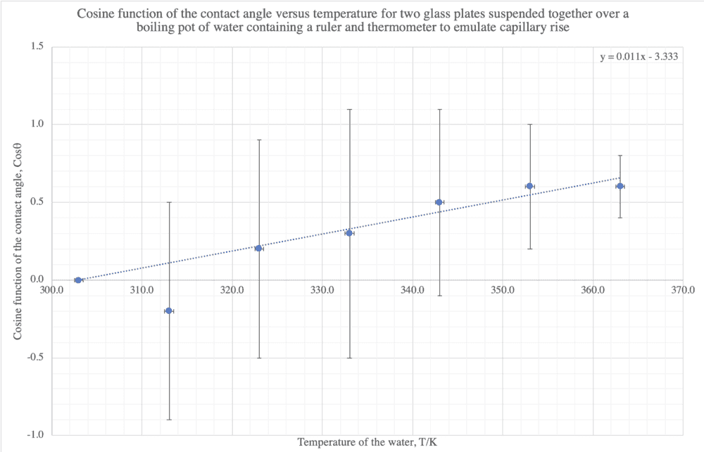

This isn't a textbook problem, but rather I am currently writing my practical report and have encountered several problems due to a high equipment uncertainty which has led me to a standstill. Attached is a diagram of my graph with the appropriate uncertainties, however, I am finding it difficult to draw the max and min slopes which encompass all the uncertainty. I would appreciate any guidance. Thank you

Can you explain a bit more in detail what you are plotting and how you estimated your uncertainties? If you are plotting the cosine of an angle vs. temperature, the point at, say 335 K shows an uncertainty from -0.5 to 1.0 in the cosine which corresponds to an angle uncertainty from 0 to 120 degrees. Is that consistent with what you observed?
And how can the max temperature of your boiling water be 360K (~ 87C)? I must be misunderstanding this...

Further to @kuruman 's comments in post #2, consider whether the uncertainties are independent. Quite possibly there is a source of uncertainty which would have a roughly constant affect across all datapoints, so would not affect the slope much.
