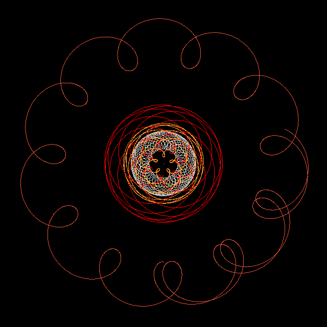

The point about phases of the inner planets is that they orbit the sun and are sometimes "dark side" towards us and sometimes "light side" towards us. But the outer planets are always light side towards us because they're never between us and the sun.
Isn't this explained by this model?
Qualitatively yes, possibly. Quantitatively no. That's why systematic detailed measurements of the positions of something like Jupiter would be needed - to show that the detailed predictions of heliocentric theory are accurate and the detailed predictions of a geocentric theory like your sketch are not.
But can't you transform the equations of motion from a barycentric system to an Earth centred one? Yes they would be more complex but would predict the same outcome.
Regards Andrew
Yeah. But the model illustrated in #28 (on which I was commenting) doesn't have anything orbiting the Sun. So it's a distinct model compared to a non-trivial presentation of a heliocentric model, which is what you are talking about.
Likes andrew s 1905
  • #32
I agree but I was trying to reinforce the point I made in post #27. You either need to appeal to "simplicity " or a fixed reference frame ( stars, QSO etc.) to establish a barycentric system.
This is the lesson relativity is it not?
Regards Andrew
