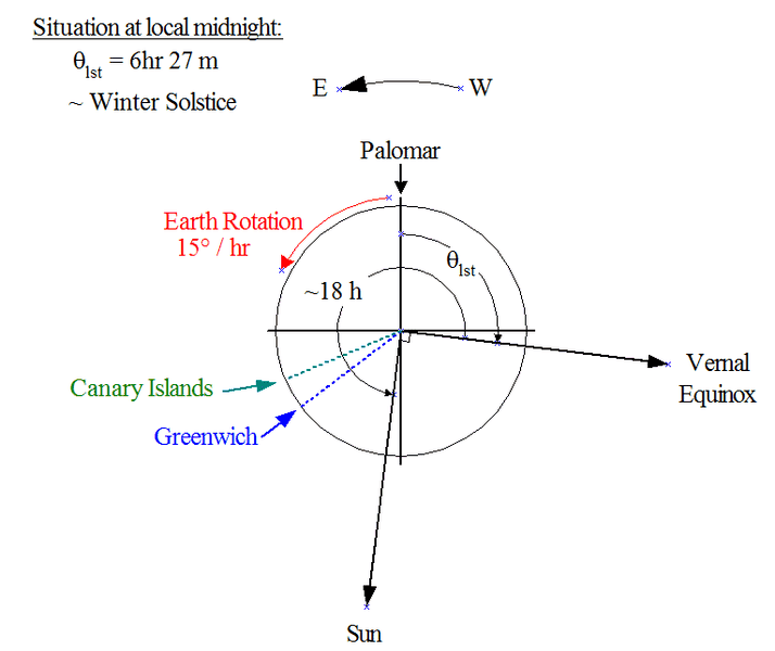

I suggest that you start these sorts of problems with a sketch and locate the significant geographical locations and the celestial directions for the given epoch (in this case the epoch is LST = 6hr 27m on December 21 at Los Palomar Observatory). For example:
The above is a view looking down on the Earth from above the north pole, with the Earth turning counterclockwise.

In the diagram I posted imagine turning the circular Earth 15 degrees (approximately, because a mean solar hour is not identical to a sidereal hour) clockwise. The directions to the Vernal Equinox and Sun remain essentially fixed. That effectively turns time back one hour to 23:00 local time at Palomar. You should see that the westward angle between Palomar and the Vernal Equinox is now smaller by 15°. The same goes for the westward angle from Palomar to the Sun...

For the local hour angle of the Sun? Remember that the right ascension of the Sun is measured eastward from the vernal equinox, while the local hour angle is measured westward from the observer's meridian. Check the angles marked on the diagram. How many hours is the sun past the vernal equinox position going westward?
6 hours?
Yes, six hours.
