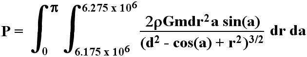

Second, to account for the entire spherical surface, I need to integrate the equation for a = 0 to П. And third, to account for the thickness of the asthenosphere, I need to integrate it for r = 6.175 x 10^6 m to 6.275 x 10^6.
My final equation is in the picture here.
Complicated, I know, but that's where I'm at. I don't think there's anything wrong with my physics, but there may be. I'm also unsure how to solve the equation. So I actually decided to make some simplifying assumptions and solve the equation, but the answer I got seemed way too high. That led me to considered the moon itself, just for the sake of comparison, and I still think the answer isn't anywhere close to right.

So the pressure caused by the moon is about 3,000 times the pressure caused by the weight of the rocks? Why doesn't the asthenosphere explode out of the Earth? Again, something is clearly wrong here. It may be my physics, but it may also be my math. And again, any assistance anyone can provide on this would be appreciated.

It is important to take the effect the moon has on the entire planet. The moon will exert a gravitational pull on the whole planet, so any net force will come from differences in this force. Pressure is just force per area, so any extra pressure will also arise from this difference in force.
Your equation for pressure is a statement of hydrostatic equilibrium (see wiki article). All quantities are related to the earth, including density enclosed in radius "h" and the gravitational acceleration. It is possible to proceed from here, but the effect of the moon is to reduce the effective gravitational acceleration, "g". At any point on earth, the total gravitational acceleration will be the acceleration from the Earth plus the acceleration from the moon. These two accelerations will add like vectors, as you indicated. You've already much of the legwork in this regard.

Brandon: The fact that the Earth is not being torn apart by the Moon is indeed a sign that you did something wrong.
This is the key concept that Brandon missed.
Fun facts, the moon raises a tide of about a meter in the Earth's ocean water. This is the ocean tidal height, since water is much more pliable than rock. The moon does pull the crust, but it is a very small amount (~cm maybe? I'm not sure).
Sub-meter level, about 15 cm horizontally, 30 cm vertically.
Brandon: Do your calculations right and you should get something like the Earth tides. You will need to introduce some magic numbers that model where the Earth lies compared to the extremes of a perfectly rigid and perfectly fluid body. One set of such numbers are the Love numbers, named after A.E.H. Love. Unfortunately, googling "Love number" will mostly result in migarbages, most of which you do not want to open. You will have slightly better success googling the term "k2 Love number".
