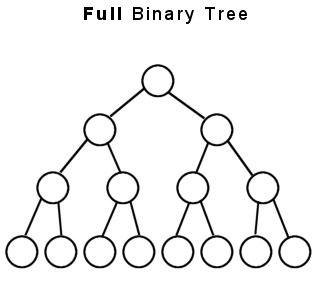

In this image, we've a tree of height 3. When we start from the left-most node, we get the following number of loop runs for successive elements:
##1,1,2,2,1,1,3,3,1,1,2,2,1,1##

Your approximation is not strong enough. In your half-tree, h occurs only once, h-1 occurs only twice, and so on. You can use this to derive a stronger bound (you can also find the precise number of steps).
Note that it is not sufficient to just consider the case where k is the whole range of the tree, O(h+k) should hold for every range in it as well.

I would first show that going through the full tree is O(k+h), then showing that going through more than half of the whole tree is O(k+h), then show that you can split every other sequence into those cases plus O(k+h) steps overhead.
