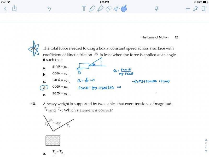

The total force needed to drag a box at constant speed across a surface with coefficient of kinetic friction Uk is least when the force is applied at an angle theta such that
a.sin(theta) = Uk.
b.cos(theta) = Uk.
c.tan(theta) = Uk.
d.cot(theta) = Uk.
e.sec(theta) = Uk.
F = ma
Ff = Uk * Fn = m*g*Uk
Fx = F *cos(theta)
Fy = F*sin(theta)
First the answer is d. cot(theta) = Uk
I tried to solve it, but couldn't figure it out...
This is my work
Since it is dragged at constant speed, the acceleration is 0. So a = Ftotal/m = 0
Ftotal = F*cos(theta) - (mg - F*sin(theta))Uk = 0
F*cos(theta) / (mg - F*sin(theta)) = Uk... which is wrong...
Can anyone help me?
So far, so good.
Realize that F is a function of theta. You'll need a bit of calculus to figure out the value of theta that minimizes F.
Question: Did they give a diagram defining the angle theta?

They did not give me any diagram defining the angle theta.. Can you help me out little bit more using calculus?? I still don't get it :(

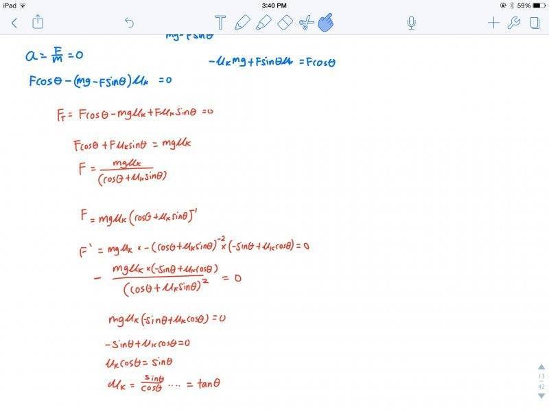

Ok... I tried my best... and got tan(theta)... Ughhhh why is this so hard to me

AlephNumbers said:
I don't think this requires calculus. Just some algebraic manipulation.
Can you help me out?
Given how you defined theta, I would say that was correct. (That's why I asked if you had been given a diagram.)
Likes gijungkim
So when do I get cot(theta)?? where does the theta have to be to get an answer cot(theta)??
Since cot(theta) = 1/tan(theta), you'd get cot(theta) if you let theta = angle with the vertical.
