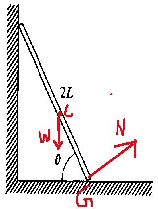

When the plank leavs the wall at angle ##\theta ##,
Torque about ground ## \tau _g = mgl \cos \theta = \frac { m(2l)^2 \alpha }3##
Torque about COM ## \tau _c = Nl =\frac { m(2l)^2 \alpha } {12} ##
Acceleration of COM: a = ## [g^2 +( \frac N m )^2 - 2 g \frac N m \cos \theta]^{0.5} = \alpha l ##
Is this correct so far?
I think the last eqn. is wrong as further calculation gives ##\cos \theta =1##
Is your free-body diagram complete?
Yes, it is.
The wall could not exert any force as the plank leaves it.
So, there are only two forces acting on it which I have shown already.
What is ##\alpha## and where does it come from in the torque equation? There is also the motion of the center of mass to consider.

Normal force is perpendicular to the surface. You have the orientation of ##\ \vec N \ ## wrong in your FBD .

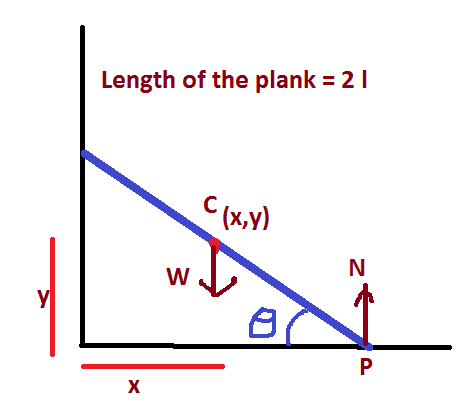

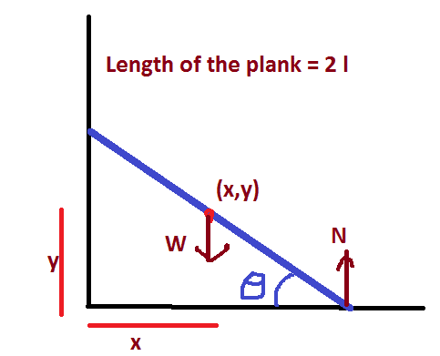

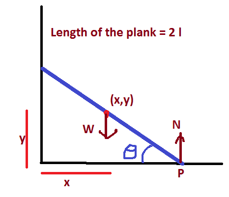

Another attempt :
Center ūf mass motion gives,
mg(-\hat y ) + N \hat y = m\ddot y \hat y ~~~~~~~~~~~~~~~~~ \ddot y <0. ~~~~~~~~~~~~~~(1)##
## y = l \sin \theta
\\ \ddot y = l\{\ddot \theta \cos \theta - \sin \theta {\dot \theta }^2\}
I can't decide here whether ## \ddot \theta ## is positive or negative.
Since the torque about both center of mass C and pivot P is anti - clockwise,
considering ## \vec \tau = I \vec \alpha : \vec \alpha = \ddot \theta \hat z, ## I decide ##\ddot >0. ~~~~~~~~~~~~~~~~(2)##
But this method is valid only if ## \vec \tau = I \vec \alpha## is valid only for fixed axis rotation.
Using (1) and (2) ,
##N- mg = ml[ \cos \theta ~\ddot \theta - \sin \theta ~ {\dot \theta }^2 ] ~~~~~~~~~~~~~~~~~~~~~~(1.1)##
Similarly,
## \ddot x =0 ~ and~ x = l \cos \theta ## gives,
##\ddot \theta = \cot \theta {\dot \theta}^2 ~~~~~~~~~~~~~~~~~~~~~~~~~~~~~~~~~~~~~(3)##
(1.1) and (3) gives,
##N - mg = \frac {ml {\dot \theta }^2 \cos {2 \theta} } {\sin \theta } ~~~~~~~~~~~~~~~(4)##
Now, considering rotational motion about center of mass,
Torque about center of mass,
##Nl\cos \theta = I_{cen} \alpha ~~~~~~~~~~~~~~~~~~~~~~~~~~~~~~~~~~~~~~~~~(5)##
Now, can I take ## \ddot \theta = \alpha##?
