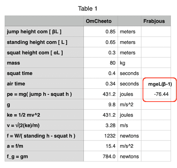

Can you explain your first equation. It looks to me like you are multiplying L and β, which are both distances which ends up yielding ke = mgh2,
which I do not believe is correct. I also don't understand why you are subtracting 1 from β.

##\alpha## and ##\beta## are non-dimensional. I am essentially doing ##\Delta##KE=-##\Delta##PE
I assume that the legs apply constant force between ##\alpha##L (v=0) and L (v=ve). The person reaches a maximum height of ##\beta##L under gravity alone, a distance of (##\beta##-1)L.
I then use the SUVAT equations on earth to determine a.
I then use the SUVAT equations somewhere else to determine vm
Instead of using SUVAT, I could have used energy expended at the point one leaves the ground giving
##\frac 1 2##mve2+mgeL(1-##\alpha##)=##\frac 1 2##mvm2+mgmL(1-##\alpha##)
ve2+2geL(1-##\alpha##)=vm2+2gmL(1-##\alpha##)
vm2=ve2+2(ge-gm)L(1-##\alpha##)
vm2=2geL(##\beta##-1)+2(ge-gm)L(1-##\alpha##)
vm2=2geL(##\beta##-##\alpha##)-2gmL(1-##\alpha##)
which gives the same answer

This still doesn't make sense to me. Perhaps if you would tell me what values you've assigned to L & ##\beta## , I can figure it out myself.
Using your values of ##\beta##L, L , ##\alpha##L gives ##\beta##=.85m/.65m=1.31 and ##\alpha##=.3m/.65m=.46 and L= .65m for initial conditions.
I get ve=1.99m/s
For zero g environment, I get vm=3.29m/s
I get a=5.6m/s2 so f=15.4m/s2
So using m=80kg gives F=1232 newtons
PE=mgeL(##\beta##-1)=80kg*9/8m/s2*.65m(1.31-1)=158joules
Note: my potential energy is calculated using h=.85m-.65m=.2m because only gravity applies in this regime which allows me to calculate ve which is the velocity at .65m which is the point feet leave the ground.
