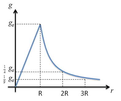

What everyone here has posted and has been trying to convey to you is that, IF we assume that the Earth is a sphere (which is not a bad approximation), and if we the mass density is uniform and constant (which it isn't), then gravity inside the Earth will reduce linearly to zero at the very center, i.e.
So this is the simplest case. Even if we remove the uniform and constant density, if the mass density can be approximated as being more or less a function of only the radial distance from the center of the earth, then the graph representing g inside the Earth may not be accurate anymore, but the value of gravity is still zero at the very center due to spherical symmetry.
Zz.

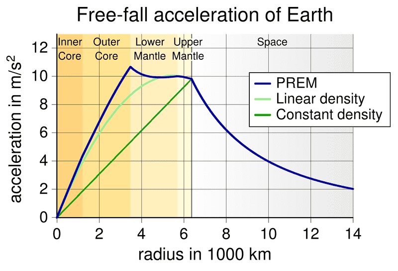

Uniform density is a quite poor model of the earth. http://askthephysicist.com/images/earthdensity.html Because the core is so much more dense than the mantle and crust, the (calculated) acceleration due to gravity is actually about constant about 1/3 of the way to the center where it increases slightly and then falls fairly linearly to zero at the center.
