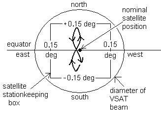

@phyzguy
I was told that there are communication satellites that are constantly stationary. That is how they can communicate with the ground; if they move around the planet then they quickly lose communication with their station. Is that wrong? If a stationary satellite “falls“ it must start off very slowly.
Also, I saw a video of guy back in the 60s ride a balloon all the way up to Earth's orbit. Yeah it was cool. He videoed himself jumping out. I wonder why he didn’t burn up. I think the guy still alive. Also is there something called maximum velocity? Or something like that?
Likes davenn
  • #54
Geostationary satellites are 26,000 miles up. The atmosphere starts at about 100 miles up. If a satellite falls from 26,000 miles up to 100 miles up, it gains a huge velocity. You should be able to calculate how fast it would be going when it hit the atmosphere by calculating the change in potential energy and equating it to the gain in kinetic energy.
He rode a balloon up to the edge of space, but he didn't ride it into orbit. In order to orbit, he would need a lateral velocity of about 18,000 miles an hour. There is no way to do this with a balloon. Most of the energy expended by a rocket putting a payload into orbit is in accelerating it laterally. This energy requirement is quite a bit larger than what is required to lift it into orbit.
Likes Rensslin
They complete one Earth orbit every day, therefore they are not stationary. They are, however, always in the same place in the sky so that once you point your antenna at one it will stay pointed at it.
