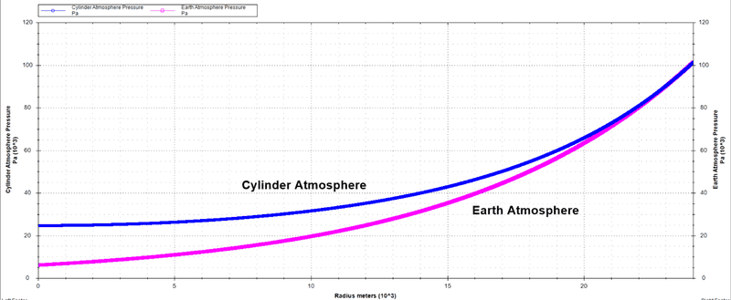

Altogether, though, when I ran the numerical integration, the curve I got using eq. set 2 did not look physical:
(Earth atmosphere included for reference in pink)

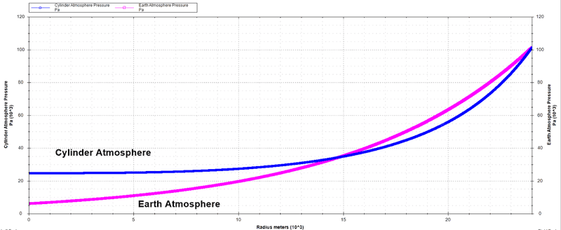

And using eq. set 1:
Doing some more work on eq. set 1, I've come to realize I'm pretty sure that "symmetry" I noticed actually proves that ##\frac{dP}{dr} = 1##, so it's literally just a linear slope, with perhaps a bit of a curve because of my numerical methods being very basic.
To be honest, both of those look less physical to me than the first equation, which didn't take into account the fact that there's less air resting on top of each air element due to the circumference shrinking as you approach the cylinder's z-axis:

Trying that in the numerical code, it works... disturbingly well, at least to my intuition:
That would be some great cosmic humor if it really was that simple all along...
