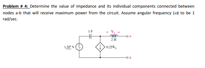

Hi, I am having trouble trying to determine Voc on this circuit.
I have done the following to attempt it:
1) Converted my Voltage source to rectangular format (from polar)
2) Converted my capacitor and inductor to Xc and XL
3) I tried using KCL to find Va that's at the three-way on the circuit, with ground node put at the bottom of Vd.
4) I've done method 3 of Thevenin equivalent circuits (using Vtest at nodes a and b of the circuit, shorting my voltage source, and solving for Zth anyway).
I just can't wrap it around my head how to find Vth knowing that my current source requires voltage off of the inductor.
I've asked one of my professors from another class and he told me to use superposition, but it doesn't make sense to me either.
Any help would be greatly appreciated, thank you!

It would help if you showed your results so far. This way you can get some feedback.
b?
Also, what is Vd? Did you mean Vb?
What is the current through the inductor during open circuit condition?

The Thevenin impedance is the equivalent impedance between nodes a and b.
If it is an open circuit, how much current would flow through the inductor?

Wouldn't that be considered a current of 0 going through the inductor?
It's an open circuit, meaning it is infinity resistance, therefore the resistance of air is so high no current is able to complete the circuit. At least that was what I learned in my previous courses.
I will find out the answer tomorrow and report back in case anyone is curious of the results. I just figured I could solve this before class tomorrow morning as good practice.
Thank you!
You are correct as far as the current through the inductor. I'm glad that scottdave asked you that question. That means there is no voltage drop across the inductor in this open circuit coindition.
The problem for Voc was solved. Thank you for everyones help. VL=0v. Therefore Id=0.25*0, making the Voc equal to 1V=Vth. It was a dumb question, and i knew in my head it was 0V for VL (i just thought it was a trick question somehow).
