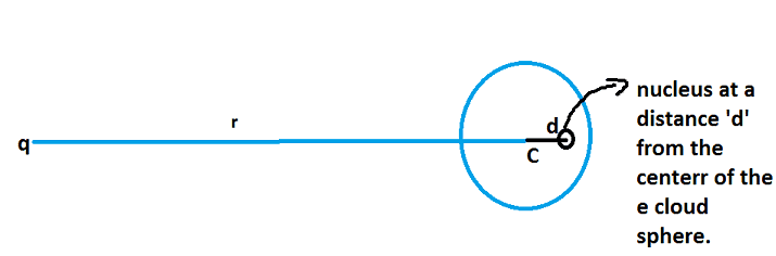

Let's consider the primitive model of atom i.e. the nucleus is surrounded by an electron cloud.
Let's say that the nucleus has charge qa and it moves a distance d from the center in the equilibrium position.
## E = \frac {kq} {r^2} \\ = \frac { kq_a d} {r^3}
\\ p = αE = q_a d, q_a = α E /d
\\F = q_a E = \frac {kq q_a} {r^2} \\= α E^2 /d = \frac α d {\{ \frac {kq} {r^2}}\}^2##
So, I am getting answer in one unknown term i.e. q_a or d.
Pushoam said:
##\\F = q_a E ##
This is not the attractive force between the charge and the atom. It is the force you would get between "one charge" in the atom (approximating it as two charges), but there is also the opposite charge of equal magnitude at a different position leading to a force.
What I calculated was magnitude of force due to q on the nucleus ( taking r+ d ≈ r as d<<r).
Since r << R ( radius of the e-cloud), let's approximate the e - cloud as a point charge at the center of the cloud.
Then under the approximation r+ d ≈ r, net force on the atom i.e. ##F_{atom} ## is 0.
So, avoiding this approximation,
## F_ {atom } = \frac {-α\{kq\}^2} d {\{ \frac {1} {r^4} - \left [ \frac {1} { \{ r +d \}^4} = \frac {1 - \frac { 4 d} r} {r^4} \right ] }\} = \frac {-4α \{k q\}^2} {r^5} ##
So, because of the polarizability of the atom, the net force on the atom is not zero. Net force falls off as ## \frac 1 {r^3} ## i.e. faster than the electric field of the point charge.

That sounds right.

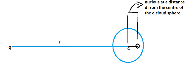

Sorry. I am solving it again from the start. Please check this .
In the equilibrium, on the nucleus, the electric field due to q is equal and opposite to that due to the negative charge cloud .
Now, ## \vec p = \alpha \vec E ##
The applied external field is different at different points in the sphere.
So, I take ##\vec E ## as electric field at nucleus due to q i.e. ## \vec E_+##.
## p = q_a d = \alpha E_+
\\ q_a = \frac {\alpha} d { E_+} ##
Now, r is so big compared to the atomic size that I approximate the cloud sphere as a negative point charge at the center.
## E_+ = \frac {kq} { \left ( r + d \right)^2 }## is electric field at nucleus
##E_- = \frac {kq} { r ^2 } ## is electric field at the center of the negative charge cloud sphere## F_{atom} = q_a \left (E_+ - E_- \right) ##
## F_{atom} = q_a \left (\frac {kq} { \left ( r + d \right)^2 } - \frac {kq} {r^2} \right) ##
where q_a is the charge of the nucleus.
Taking the approximation,
## \frac 1 { \left (r + d \right )^2 } = \frac {1 - \frac {2d } r} {r^2} ## and substituting the expression for ## q_a#### \begin {align}
F_{atom} & = {\frac α d} { \frac {kq} { \left ( r + d \right)^2 } } \left ( {\frac {kq} { \left ( r + d \right)^2 } } - { \frac {kq} {r^2}} \right)
\\& = \frac {αk^2 q^2} d \{ \frac {-2d} {r^5 } + \frac {4 d^2 } {r^6} \}
\\& = \frac {-2αk^2 q^2} {r^5}
\end {align} ##
[ignoring the second term as it is very small compared to the first term]
Hence, ## \vec F_{atom} = \frac {-2αk^2 q^2} {r^5} ~\hat x ## i.e. towards the charge q.

Another way to solve the same problem:
Attractive force on atom due to q is equal and opposite to the attractive force on q due to the atom.
For r>> atomic size, the atom could be reduced as a dipole.
Electric field due to this dipole at q ##\vec E_{di} = \frac {2k\vec p}{r^3} \\\vec p = \alpha \vec E_{due~ q} = \alpha \frac {kq} {r^2} \hat x##
Attractive force on q : ##\vec F_q = \frac{2\alpha k^2 q^2 } {r^5} \hat x##
Likes TSny
Pushoam said:
Since α depends on the atomic structure and hence is constant for a given atom. What I conclude from the above arguments is :## E_+/d ##must be a constant with appropriate unit.
What about this?
Pushoam said:
What about this?
I think that's right.
