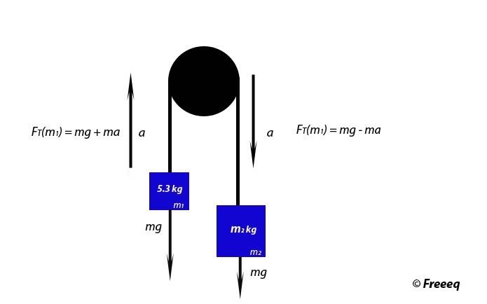

Smaller mass on an Atwood machine is 5.2 kg (m1). If the mass accelerates at 4.6 m/s2what is the mass of the object? What is the tension of the rope?
a = g(m2-m1)/(m2+m1)
I can't approach this questions, because we always worked with two masses and had to find acceleration and tension of the string, but we have never worked without the second mass.
Draw a free body diagram of the forces acting on the smaller mass. What forces are operating on it? What does Newton's second law have to say about the net force and resulting acceleration on a given mass?
That's what I did. According to Newton's law the forces need to be equal on boths sides.
(Left side)
Ft=m1g+m1a
Ft=(5.2x9.8)+(5.2x4.6)
Ft=74.88N
Then I can sub in Ft into the second equation.

I see that in your diagram, on the left hand side, you have an equation relating the forces acting on the smaller mass.
Your equation is FT = mg + ma. Since FT must be acting upwards on m, and mg must be operating downwards, and since the acceleration of the mass must be upwards (it's the smaller mass), then the equation should probably look like: FT = ma - mg for this smaller mass.
Now, for which of the variables in that equation do you have values?
EDIT: Silly me. ma should be the reaction force. That does indeed make it FT = mg + ma as you wrote. Apologies.

If the smaller mass is accelerating upwards, then the force on that mass due to the tension in the cord exceeds the force due to gravity on that mass. Thus I write ma = T - mg, or T = ma - mg. This allows you to solve for the tension given values that you have in hand, namely the mass and acceleration of the small block. Try it.
EDIT: Doh! ma = T - mg, so T = ma + mg.
Sorry about that. I've been up to long...
for m2 and plug in the known values of a and m1to find m2.
Good luck!
Freeq said:
(Right side)
Ft=m2g-m2a
Ft=m2(g-a)
I forgot to fiinish this so,
m2= Ft/(g-a)
m2=74.88/(9.8-4.6)
m2=14.4kg
BTW: I goofed on the picture - I wrote the mass of smaller object 5.3kg which it should be m1 5.2kg
Then I want to prove you AGAIN that this is right, by using the formula you mentionied in your post above.
a= g(m2-m1)/(m2+m1)
a= 9.8(14.4-5.2)/(14.4+5.2)
a= 4.6 m/s2
Which is right, because the acceleration given in the question is 4.6 m/s2
