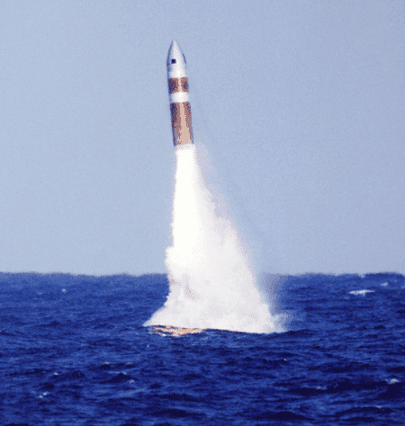

I agree that the usage of the term is generally if not exclusively about aerodynamic lift/drag on winged craft. And based on that, the usage of the term here (increase in "lift" of a rocket close to the ground) is a bit of a bastardization. But it's a bastardization that everyone else has seemed to understand and accept.
I remember reading that these sub-launched missiles have to attain a minimum height above the water before ignition of the rockets. Otherwise, the rocket blows up because of too much backpressure.
From that point of view, it's remarkable that the rocket in this video didn't explode because of the same problem. The launch pad can be excavated below ground to divert the exhaust gasses, but once it drifted away, that's no longer available.
