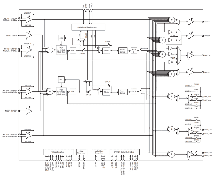

Unfortunately, this one only does the Bluetooth  Jack 3.5mm connection and can’t go backyard. Moreover - as you can see in the table upward – I also need to do the Bluetooth <-> Bluetooth connection, and for that I need a full-duplex (receive and transmit at the same time) Bluetooth module (to use only one Bluetooth module, and not two).Because I can’t find any pre-built audio stereo Bluetooth module that can go from Bluetooth to jack and vice versa, and perform full-duplex Bluetooth trans-reception, I abandoned this idea of using existing audio module.Thus, I need to build my own audio board, with ADC, DAC, amplifier, Bluetooth module and so on. I know this is very complicated stuff (at least for me), therefore I am here to seek your advices.In order the convert the analogic / digital audio data, I choose this audio codec: TLV320AIC3106-Q1. This is an automotive low-power stereo CODEC with 10 analog inputs, 7 analog outputs, HP amplifier and a max sampling rate of (96kHz enough for audio data converting). This one is from Texas Instruments.
xGMjmrn
As you can see in this functional block diagram, there are 10 analog inputs, 6 analog output and two digital pins at the top: DIN and DOUT (with their clock pins).In relation with this module, my questions are the following:- How will I be able to amplify the analog outputs (using the integrated amplifier but how, with which pins? Not matter how many times I read the datasheet, I can’t see this information).- Do you think this audio codec is enough for my needs? I need to connect 3 different analogic devices (Jack, Induction coil, and Radio FM), but the datasheet says the module only has 2 different ADC channels. Well, I don’t understand it also says it has 10 analog inputs?Using this audio codec, I can convert analogic audio data to digital audio data, and hopefully I can send those data to my Bluetooth transceiver module. I choose this module : RN4020-V/RM. This module has a data rate of 1MBPS (>192kbps which is the bit rate of the MP3 audio file). This module has an UART interface (RX and TX), but how am I supposed to send the digital audio data coming from my audio codec to the UART interface of the Bluetooth module? The only option I see is to use another module to make the link between the two… But what module, Arduino board?I also looked at the RN4020-V/RM datasheet and I can’t see if this module can do full-duplex communication, receive and transmit at the same time.I hope my explanations weren’t confusing… As you can see, I got myself involved in a project way to hard for my skills. But that is no reason to give up.If you see anything odd or wrong with my way of thinking, please tell me.Thank you so much for your help! You’re helping a young boy building up its skills, and this is priceless.
