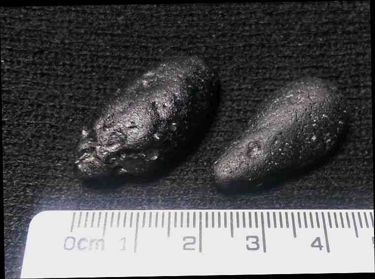

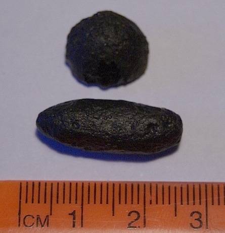

I have a number of tektites from this source/strewn field, including...
Australia,
Philippines
Thailand
Dave
