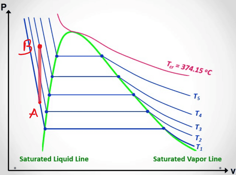

Your refrigerant is going through an isochoric process as it takes heat from the engine. It's getting much hotter than it would under normal operation in which it'd relieve some volume as pressure increases.
Since it's hotter, it cannot take as much heat from the engine so the new steady state is at a higher temperature so you're reading a higher temperature in your engine as well.
That's my take on it at least. I have only worked at an amateur level with engines and it's my first time seeing a problem as the one you're describing but the explanation seems plausible.
By the way, I doubt there is boiling going on as you mentioned. If the refrigerant were able to boil, it'd do so and at some point, you'd have a lot of gas in your system which would introduce several complications.
Expanding on that, notice in the following picture how moving vertically (keeping the same volume and increasing the pressure A→B) in the liquid region (at the left of the green curve) the temperature increases significantly.
That's for water which is most likely very different to your refrigerant but the behavior is kind of like that for fluids.
Picture taken from this video. I haven't actually watched the video because I just needed the picture but I prefer to link the sources anyway.
