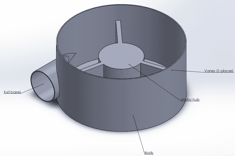

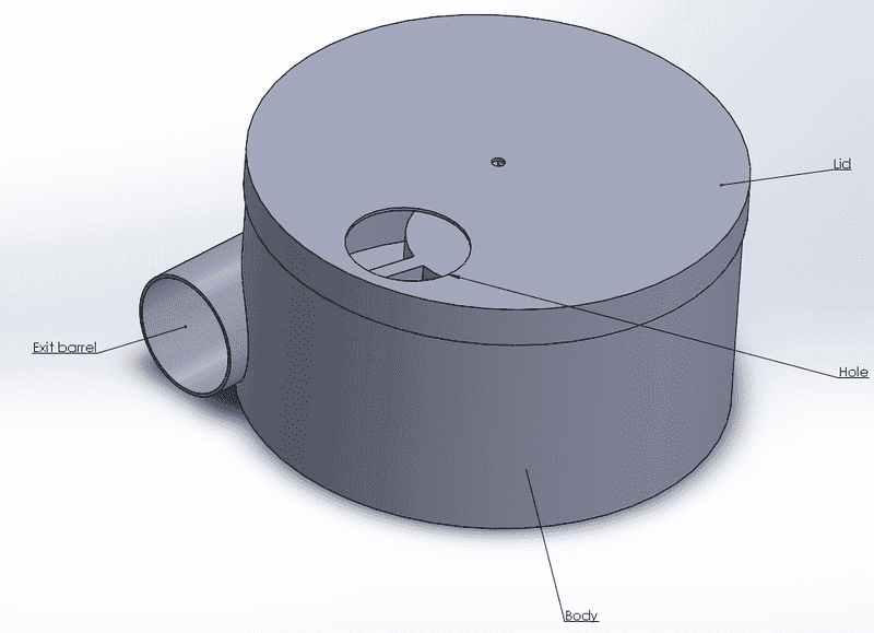

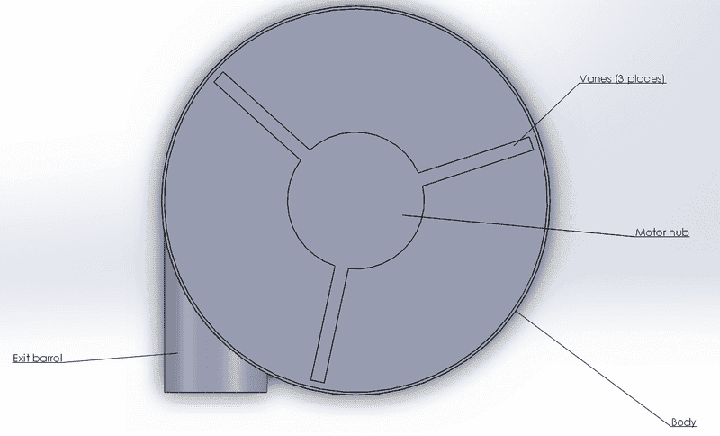

Conceptual design is shown in three attached images, 'ball launcher image with annotations.png', 'isometric view lid removed.png' and 'plan view lid removed.png'.
Bucket outside diameter is approximately 280mm. The basic idea is that sensors detect when the ball has been loaded. A positive ball detection triggers the motor (not shown, it will be situated underneath the unit) to rotate the hub and vanes within the bucket. The vanes rotating will launch the ball out of the barrel. Solar panels (not shown) likely mounted somewhere on the lid will charge a battery bank (not shown) situated underneath the unit next to the motor.
I scaled this unit down and 3d printed a prototype attaching a small DC motor; I was concerned that the ball wouldn't launch properly. But the prototype functioned well so that is encouraging.

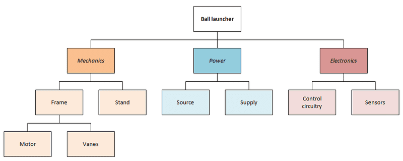

I have broken this project down into three main sections: mechanics, electronics and power as shown in 'system overview.png'.
I will use an Arduino Uno to control the launcher, but if anybody has alternative suggestions I am happy to hear them.

Looks good. Perhaps add some safety features so that the power is shut off if the dog drops a stone or stick in the bucket and it jams the rotor.
Doc said:
2. I think it would be easy to construct this thing out of a plastic bucket with a lid. A hole can be cut in the lid where I will need to train the dog to drop the ball into (ha! Training him to do that will be the hard part!.
Be a lot easier on the dog if you made this a funnel instead of just a hole

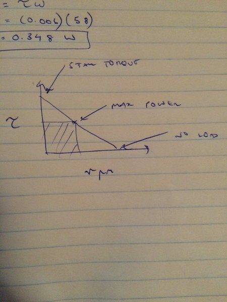

Hi all,

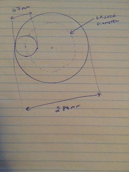

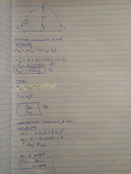

Okay, I've worked out that the resultant launch velocity of the tennis ball needs to be about 7 m/s. In order to launch the ball, ideally, a distance of 3m, a launch velocity of approx. 3.8 m/s is required. However I am going to assume this system will have a lot of loss, so I will aim for a launch velocity of 7 m/s. All working attached 'required launch velocity.jpg'.
Now I need to convert a linear launch velocity of 7 m/s to an angular velocity and then to a spec. that I can use to select an appropriate motor (rpm). Angular velocity is linear velocity divided by radius. My radius however is not 280/2 mm (I stated in my first post that 280mm was the bucket outside diameter), see ' launch diameter.jpg'. I calculated the launch diameter to be approx. 246.5mm, the radius is of course 123.25mm.
I think that what I need to do from here is estimate the mass of the rotating central hub and the vanes: perhaps use plywood for the vanes, I might change the geometry of the hub to a triangle and use pine so it's easy to put together. Once I have the mass of the central hub plus the mass of the tennis ball I can determine the torque required to rotate everything. I can then create a few plots using stall-torque and no-load speed data from motor datasheets. I want to select a motor which has a maximum power point close to what I think my actual torque and RPM will be, see 'torque speed.jpg'.
Any advice/criticism on that last paragraph in particular would be appreciated.
Thanks,
Doc

Doc said:
I am assume that you think that the total energy demand may be prohibitively high for a compact unit? Or is there something else that I am missing here?
It's not the amount of energy that is worrisome, it's how fast it needs to be delivered: That's power (energy over time).
For example, let's say your ball has a mass of 60 g and the initial velocity is 7 m/s. The net energy required by your machine is ##\frac{1}{2}mv^2## or 1.47 J (= 1/2 * 0.060 * 7²).
If you have a spring loaded machine that loads the spring while the dog is chasing the previously thrown ball and that the dog takes 5 s before coming back with the ball, you can use a motor producing as low as 0.294 W (= 1.47 / 5). If you go with your machine that starts when the ball drops in (which should turn at around 500 rpm to produce the required 7 m/s), you will have 1/500 min to do that 1 rev before the ball exits, or 0.12 s. So you need a motor that produces at least 12.25 W of power (= 1.47 / 0.12). And that is only considering the mass of the ball, not including the inertia of the rotating machine itself or the friction losses.
And if you want to start your machine from rest every time, you have to think that you will need to go from 0 to 500 rpm within 1 rev. You need to be able to reach such level of acceleration.
Likes Tom.G
Likes BvU
This makes perfect sense thank you, and I see now that I did not approach this problem properly. I have made design decisions without adequately understanding what I want to do.
Perhaps the way I should have thought about this is:
- I want to do x, x requires energy.
- How much energy is required to do x once?
- What are DIFFERENT ways to do x?
- How quickly will these different ways operate? This will give an approximate time associated with each option.
- Divide the energy required to do x by the time associated with each option to get Power required.
- From here it should be clear which options will require higher power (and correspondingly either high voltage and/or current) or lower power.
I think I'll go back to the start and do this step first.
