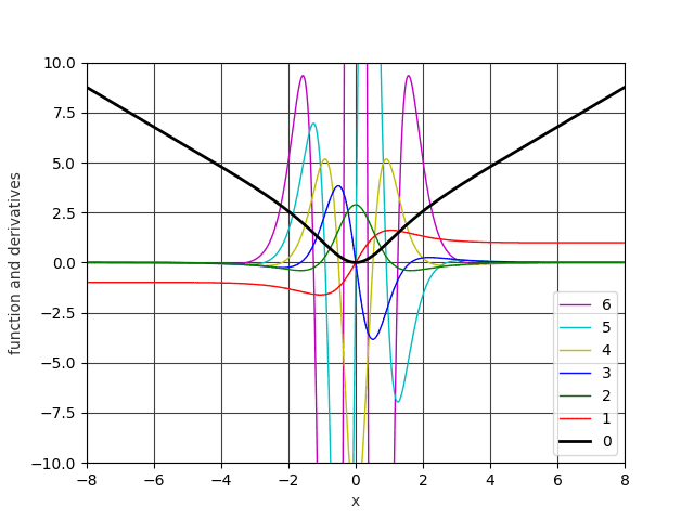

Here is a plot of the function ##x^2 / {\ln(\cosh(x) + 1)}##, together with its first six derivatives, using automatic differentiation (1001 x data points in total). The computations use 236 bit floating point precision courtesy of gmpy2 (MPFR) arbitrary point arithmetic.
246559
Here is an illustration of the CPU time involved in generating the data:
Code:
$ time -p ./models.py 0 -8 8 1001 7 1e-12 1e-12 > /tmp/data 2>/dev/null
real 0.30
user 0.29
sys 0.00

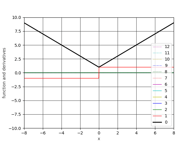

anorlunda said:
There are many problems with strong nonlinearities. Just think of a diode for example. All higher order integrations are disadvantaged in cases where the equations and/or the coefficients change dramatically from one time step to the next.
I'm sure there are degenerate/edge cases, but here is ##|x + 1|##:
246623
Yes there really are 12 derivatives here! Piecewise functions are fine as long as f() is defined at the jump (and derivatives set to zero - see next sentence!). However, this is nothing whatsoever to do with the order of integration as it begins with the first derivative as I mentioned (Euler's method and RK4 would suffer the same fate).
Really?
246664
Thanks, that's clearer.
