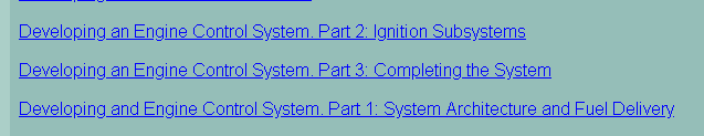

Would you accept 23 years ago?
http://www.diagram.com.ua/english/archive/circuit-cellar-magazine/1995/
About 20% down the page, "Developing An Engine Control System..." Parts 1, 2, 3
Cheers,
Tom
Likes jim hardy

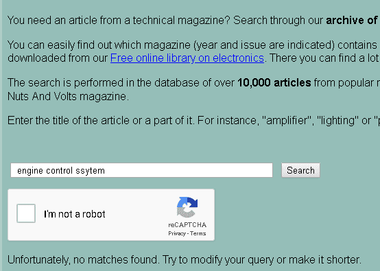

It's listed there but the page refuses to find it.
clicking them gives
Typical IT horsemanure - nothing works.
