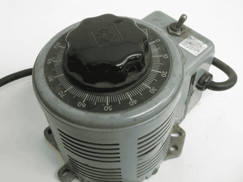

Yes, in general an isolated (traditional) transformer is safer than an autotransformer.
Having said that, it really depends on the application. Autotransformers ("Variacs") are most dangerous when used to transform an AC Mains voltage that is referenced to Earth ground, and the end user thinks that it is isolating the transformed Hot/Neutral from Earth ground. It isn't. You need the traditional isolation transformer structure to give you a floating transformed AC voltage.
But if the original AC Mains type voltage is already isolated from Earth ground for some reason, using an Autotransformer should generally be fine. Again, it depends on the application.
One other thing to consider is that a Variac Autotransformer can have its setting knob bumped or otherwise changed, so the ratio setting may not always be fixed reliably.
(Sorry for the dirty picture) :wink:

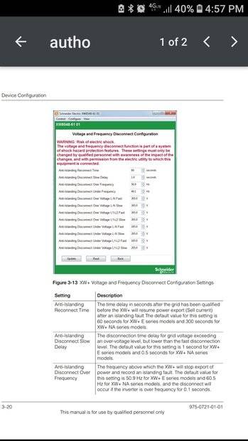

The very principle behind the energy export of solar inverters is, that they are producing at slightly higher voltage than what can be seen on the grid => if too many inverters are feeding back to the grid then the grid voltage will rise.
To keep the grid voltage at acceptable limits, the inverters are expected to shut down when the grid voltage is above certain safe limits. This is a mandatory safety function.
What that trick with the autotransformer does in the quoted type of application is, that even when the inverter is already expected to shut down due grid overvoltage, it still tricks the inverter to operate, thus: bypassing this safety function => actually it may push the grid voltage above limits.
I do understand that individually it's not really nice to lose PV production due grid overvoltage, but I highly doubt this practice being legal and safe.

This extract is from Schneider modern inverters, the table default values are for the EU models but it also applies to the split phase US models XW+..... In contrast older versions of these inverters won't allow to change anti-islanding settings...
