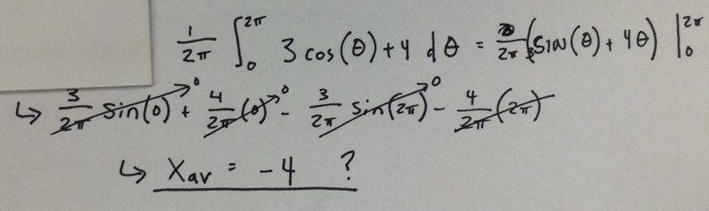

okay so after using the formula you gave me I got xav = -4
that feels weird too.. is there supposed to be a constant after I integrate?
hdp12 said:
I got xav = -4
Can you show your work? Where did the negative sign come from?
Why does the last term have a minus sign?
I may have finished the integral incorrectly... I haven't done integrals intensely since calc 2 (2 years ago) ...
I did ...
say y(t) is the integral I determined... the 3/2π sin ... etc
to solve a definite integral... y(0) - y(2π)
is that incorrect? I'm going to look it up right now
yeah its the other way around, y(2π) - y(0)
so the answer I get now is xav = 4
is that correct?

Most of it's right except for how you handled the constant at the end. You should end up with 4*2π/2π - 0*2π/2π...
hdp12 said:
is that correct?
Yes. :smile:

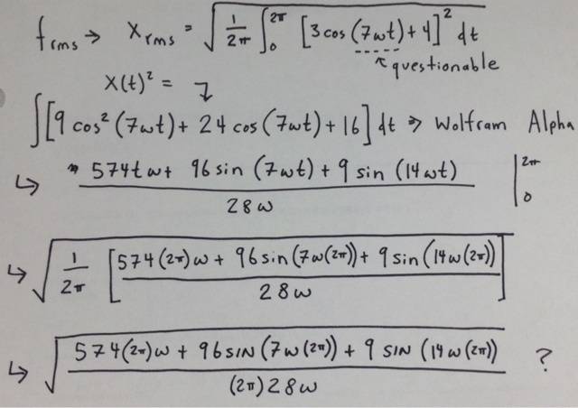

To calculate the RMS value of a function, you need to square the function, average it over a period, and then take the square root. So more like this:
## \sqrt{\frac{1}{T} \int_0^T{(3cos(7ωt)+4)^2 dt}} ##
This feels wrong
I have the wikipedia article open in another tab, and that's actually where I got the formula. Same one you gave me three posts back.
Is the work I just posted correct? I worked out the formula you & wikipedia gave me
I didn't check the math in detail, but it looks like you were doing the right things. Sure turned out messy, though...

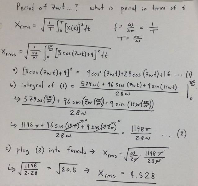

That's what I was thinking too, should I use theta instead of 7 omega t ?
The significance of the 7ωt is in relation to the period that you integrate over. The period of 7ωt is not 2π. What is the period in terms of t, since that is what your are integrating over...?
This looks about right..
Yeah! I would guess a number a bit over 4, so that looks about right. Good job!
Did you double-check the answer with Wolfram Alpha yet? :smile:
I sure did √√√
thanks for everything
