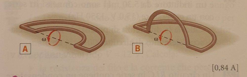

The picture shows a loop formed by two semicircles linked together by the straight sections of a wire. The loop and the dotted line lie on the same plane.
The smaller semicircle, which has a radius of 0.20m, starts rotating with an angular speed of ω=1.5 rad/s around the dotted line until it gets into a position that's perpendicular to the bigger semicircle (B).
A constant magnetic field of B= 0.35 T is directed upwards, perpendicular to the plane where the loop lies.
The loops resistance is R=0.025 Ω
Find out the induced loop current I while it changes its form, hoing from picture A to B.
