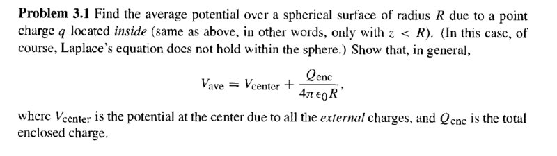

I was working out problem 4, chapter 3 of Introduction to Electrodynamics by Griffiths:
a) Show that the average electric field over a spherical surface, due to charges outside the sphere, is the same as the field at the centre.
b) What is the average due to charges inside the sphere?
I know the solution, but there are a few aspects I do not see:
Here you have the image Griffiths makes reference at:
Why ##z^2 + r^2 - R^2 = z - Rcos \theta## (law of cosines developement)?
This equality is not correct. Instead, note the following substitution
