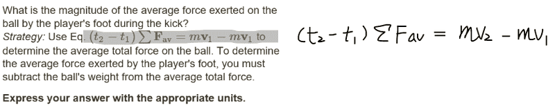

Average force exerted on the ball
In summary, the problem involves finding the average total force and the force exerted by the foot on a ball, given its initial and final velocities. The weight of the ball must be considered in the calculation of the total force, but not in the force exerted by the foot. The weight should be subtracted from the force of the kick, and the direction of the forces must be taken into account as they are vectors. The correct values for the forces are 45 N and 48.87 N for the average total force and the force exerted by the foot, respectively.

∑Fav = mv2 - mv1
We have to separate v in x dir and y dir?
Why? (Note that it starts from rest.)
but are part one and part two asking the same thing?
No. One asks for the average total force on the ball. The other part asks for just the force exerted by the foot.
For the average total force on the ball (1st part). what equation should i use?
For the (2nd part) force exerted by the foot, the equation is F = (mv2- mv1 ) / Δt
No, that will give the average total force on the ball.
That's total force exerted on the ball?
For part 1,
F = 1/ Δt * ∫ F dt ?? which is (mv2- mv1 ) / Δt ??
For part 2,
F = (mv2- mv1 ) / Δt - mg (cuz the question said subtract the weight)
Yep.
nysnacc said:
For part 1,
Yes.
nysnacc said:
For part 2,
Careful. Forces are vectors, so here you need to consider the directions of each.
For part 2
(mv2- mv1 ) / Δt (going up)
mg (going down)
what should i do with the 60 deg which is given?
That's the direction of the average total force on the ball.
Part 1, F = 45 N
Part 2 F = 41.236 N?
nysnacc said:
Part 1, F = 45 N
I'm not sure whether the hint given in the question is simply wrong or is assuming the weight, being a downward force, will be expressed as a negative quantity. Ask yourself this: does the presence of gravity increase or reduce the force needed from the boot to achieve the given velocity?
Secondly, forces are vectors. You cannot add (or subtract) forces acting in different directions by adding their magnitudes.
Is #1 correct, 45 N
#2 i have F = Fav (cos i + sin j) + mg (-j)
= (Fav cos )i + ( Fav sin - mg ) j
nysnacc said:
Is #1 correct, 45 N
Yes.
Doc Al said:
Yes.
why is my #2 not correct?
You made a mistake with the sign of the weight vector.
Fav - mg (-j) ??
so it is a plus?
So 48.87 N?
#2 is greater than #1
##\vec{F_{total}} = \vec{F_{kick}} + \vec{F_{weight}}##
To find the force of the kick you must subtract the weight vector, but the weight points down.
nysnacc said:
So 48.87 N?
Yes.
