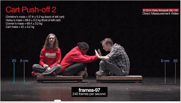

What is the Average Force between m1 and m2. Show all work.
Note that the masses are both at rest, and begin to push off of each other in opposite directions.
Their velocity is measured when they reach 20cms distance. (I calculated the velocity when they reached this point as well. Please let me know if I did that correctly as well using the kinematics formulas d=1/2(0)at^2 and vf=vi+at. Thanks.
m1=148.4 kg, velocity in negative direction = 1.47 m/s, acceleration = 5.47 m/s^2
m2=91.4kg, velocity in positive direction = 2.35 m/s, acceleration = 2.35 m/s^2
Distance both carts traveled 20cm (0.2m) velocity of each cart recorded once the cart passed this point.
Time of contact as m1 and m2 push away from each other 0.78s

I was given that in a second there are 240 frames. at 65 frames, the 148kg cart reaches the 0.2m. so i gathered:
65/240 = 0.27s so I plugged in.. d=vi*t+(1/2)at^2
2(0.2m=(1/2)a(0.27)^2)
0.4m=a(0.27)^2
0.4m=0.0729a
a=5.47 m/s^2
So basically I do have distance.. so maybe do FΔT=(m1+m2)*(d/t)
(d/t) because v=d/t?
F*(0.78)=(239.8)*(0.2/0.27)
F=((239.8)*(0.74))/0.78
F=227.73N
Does this work?? Thanks again.

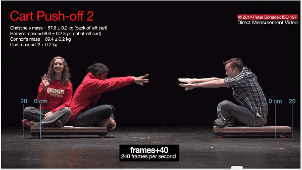

I suggest that you forget about the details of the acceleration because you don't know what they are and you cannot assume that the acceleration is constant. The kinematic equations do not apply here. All you can calculate is the average force that each person exerts on the other. You know the impulse equation Favg.Δt = m Δv.
For each cart, you need to:
(a) Find the time Δt that they are in contact pushing against each other.
(b) Find Δv which their change in velocity; this is vfinal - 0. To find vfinal, you need to find how far the cart moves over how much time after the carts are separated. You can use v = d/t only when the cart is not accelerating.
(c) Use the impulse equation to find the average force exerted while there is contact.
After you calculate the average force on each cart, verify that the two average forces are equal in magnitude and opposite in direction to within your experimental accuracy. Remember that velocity is a vector.

Thank you so much. So I went ahead and calculated..
Connor = Vc=d/t
Vc=0.2m/(41frames/240)s
Vc=0.20m/0.17s
Vc=1.17m/s
FΔt=mΔv
F=((91.4kg)*(1.17m/s))/(0.78s time of contact)
F=137.1NHailey
Vh=d/t
Vh=-0.2m/(65frames/240)s
Vh=-0.2m/0.27s
Vh=-0.74m/s
FΔt=mΔv
F=((148.4)*(-0.74))/(0.78)
F=-140.8N
Impulse for Connor
137.1x0.78= 106.94Ns
Impulse for Hailey
-140.8Nx0.78= -109.5Ns
So they almost completely cancel out, so the average force should be 0 right? Or should it be -1.8N
Fave.=(137.1+(-140.8))/2
F
ave=-1.8N
