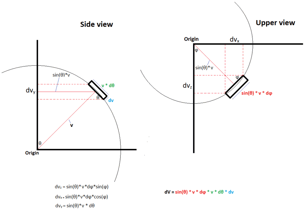

Could you please help me with the following?
I'm reading this article now regarding converting a 1D to a 3D MB Distribution. It is deriving a formula to calculate an infinitesimally small volume ##dV## on the surface of a sphere with radius ##v## in velocity space. It states that ##dV = dv_xdv_zdv_z##. I have drawn this small volume piece in velocity space myself and deduced the following:
So I have deduced that ##dV = \sin(\theta) \cdot v \cdot d\phi \cdot v \cdot d\theta \cdot dv##. This is also what the link states. However, I really can't see how this is the same as ##dV = dv_xdv_zdv_z##. According to my drawing, I have deduced that
$$dv_z = \sin(\theta)\cdot v\cdot d\phi\cdot \sin(\phi)$$
$$dv_x = \sin(\theta)\cdot v\cdot d\phi\cdot \cos(\phi)$$
$$dv_y = \sin(\theta) \cdot v \cdot d\theta$$
But I can't equate them to make ##dV = \sin(\theta) \cdot v \cdot d\phi \cdot v \cdot d\theta \cdot dv##.
First of all, it doesn't make sense to derive the 3D distribution from the 1D distribution, because the 3D distribution provides more information than the 1D distribution. The logic is as follows:
Suppose you have the distribution for ##\vec{v}##. Let's call it ##P(\vec{v})=P(v_x,v_y,v_z)##. Then the probability distribution for just one component is given by
$$P_1(v_x)=\int_{\mathbb{R}^2} \mathrm{d} v_y \mathrm{d} v_z P(v_x,v_y,v_z).$$
The meaning is: The number ##\mathrm{d} N## of particles contained in a small volume element ##\mathrm{d} V_v=\mathrm{d} v_x \mathrm{d} v_y \mathrm{d} v_z## in velocity space is given by
$$\mathrm{d} N = P(\vec{v}) \mathrm{d} V_v.$$
Now you can use any coordinates you want. The volume element ##\mathrm{d} V_v## in terms of Cartesian velocity components read ##\mathrm{d} v_x \mathrm{d} v_y \mathrm{d} v_z##.
This is easy to understand: The volume element written in some coordinates is determined by the coordinate lines, i.e., the lines, where you keep two of the three coordinates fixed and let the 3rd one run. In the case of Cartesian coordinates this leads to a grid in 3D space which defines little rectangular boxes, which of course have the volume ##\mathrm{d} v_x \mathrm{d} v_y \mathrm{d} v_z##.
Now you want the volume element in terms of spherical coordinates. To get it, you first write down the vector's Cartesian coordinates in terms of the these coordints:
$$\vec{v}=\begin{pmatrix} v_x \\ v_y \\ v_z \end{pmatrix} = \begin{pmatrix} v \sin \vartheta \cos \varphi \\ v \sin \vartheta \sin \varphi \\ v \cos \vartheta \end{pmatrix}.$$
Now consider the coordinate lines. They again lead to a specific grid of the volume, making up the volume as infinitesimal little boxes (not necessarily rectangular, but for spherical coordinates in fact they are, because spherical coordinates are orthogonal curvilinear coordinates) spanned by the tangent vectors on the three coordinate lines in the specific point. These vectors are given by
$$\mathrm{d} \vec{b}_v=\mathrm{d} v \partial_v \vec{v}=\mathrm{d}
v \begin{pmatrix} \sin \vartheta \cos \varphi \\ \sin \vartheta \sin
\varphi \\ \cos \vartheta \end{pmatrix} \\
\mathrm{d} \vec{b}_{\vartheta} = \mathrm{d} \vartheta
\partial_{\vartheta} \vec{v} = \mathrm{d} \vartheta v \begin{pmatrix}
\cos \vartheta \cos \varphi \\ \cos \vartheta \sin \varphi \\ -\sin
\vartheta \end{pmatrix}\\
\mathrm{d} \vec{b}_{\varphi} = \mathrm{d} \varphi v \begin{pmatrix}
-\sin \vartheta \sin \varphi \\ \sin \vartheta \cos \varphi \\
0 \end{pmatrix}.$$
Now the volume of this little box, spanned by these three trangent vectors is
$$\mathrm{d} V_v = (\vec{b}_v \times \vec{b}_{\vartheta}) \cdot \vec{b}_{\varphi}=\mathrm{d} v \mathrm{d} \vartheta \mathrm{d} \varphi v^2 \sin \vartheta.$$
This is of course not the same as ##\mathrm{d} v_x \mathrm{d} v_y \mathrm{d}_z##, because this is another little box than the one provided by the coordinate lines of the spherical coordinates, but it's a valid volume element in defining some 3D grid of the velocity space.
Thus the same distribution ##P(\vec{v})## can be written as a distribution for ##v##, ##\vartheta##, and ##\varphi##. Of course you have to refer to the corresponding grid given by the coordinate lines, i.e., you have
$$\mathrm{d} N=\tilde{P}(v,\vartheta,\varphi) \mathrm{d} v \mathrm{d} \vartheta \mathrm{d} \varphi =P[\vec{v}(v,\vartheta,\varphi)] \mathrm{d} v \mathrm{d} \vartheta \mathrm{d} \varphi v^2 \sin \vartheta,$$
i.e., you get
$$\tilde{P}(v,\vartheta,\varphi) =P[\vec{v}(v,\vartheta,\varphi)] v^2 \sin \vartheta.$$
Of course this generalizes to more than three dimensions: The above used "parallelipedal product" is nothing else than the Jacobi determinant,
$$\mathrm{d}^3 v = \mathrm{d} v \mathrm{d} \vartheta \mathrm{d} \varphi \mathrm{det} \frac{\partial (v_x,v_y,v_z)}{\partial(v,\vartheta,\varphi)},$$
where in our case ##q_1=v##, ##q_2=\vartheta##, and ##q_3=\varphi##.
The general transformation rule for an arbitrary multi-variable density function thus gets
$$\tilde{f}(q')=f[q(q')] \mathrm{det} \frac{\partial (q_1,q_2,\ldots,q_n)}{\partial (q_1',q_2,',\ldots, q_n')}.$$
vanhees71 said:
Explanation
Thank you so much for the detailed explanation. I got it now regarding ##dV##.
