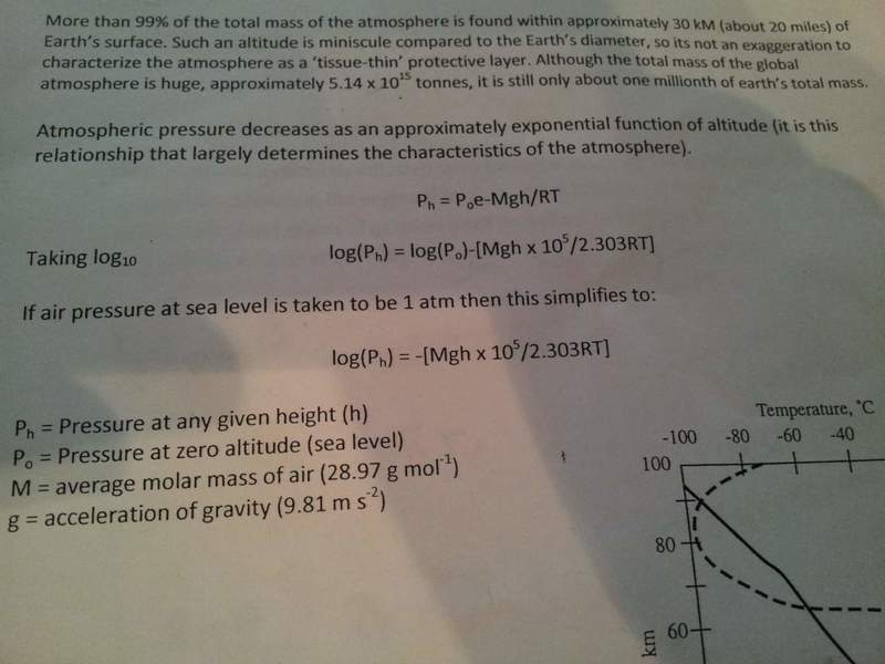

Hey guys. Hope you can help me out on this one. so here's the question:
At an altitude of 50km the average atmospheric temperature is 0^oC. What is the average number of air molecules per cubic centimeter at this altitude.
M = 28.97 g mol^-1
g = 9.81 ms^-2
R = 8.314 J K^-1 mol^-1
Ph = pressure at any given height
P0 = pressure at sea level
Ph = P0e^-Mgh/RT
Ph = P0e^-Mgh/RT
p @ 50km = 75.944Pa
75.944 x 1 x 10^-6
Ph = -------------------
8.314 x 273
= 3.346 * 10^-8. And then I need to divide this by 6.022 * 10^23
= 5.556 * 10^-32. Is this correct?
Cheers :)

Ok. I've just found another equation in my handout I have been given. It states that "if air pressure at sea level is taken to be 1atm then the equation simplifies to:
log(Ph) = -[Mgh*10^5/2.303RT]
so using this equation
log(Ph) = - [(29.97*9.81*50000*10^5)/(2.303*8.314*273)]
log(Ph) = -[1.47*10^12)/(5227.169)]
log(Ph) = -[281222971]
Ph = 10^-281222971
Ph = 0
This is obviously not correct :/ did I miss out a conversion factor?
As fast as I can tell you missed one and added one that is not necessary. 28.98 is in grams, and I don't understand what is 105. Besides, now your pressure is in atm, previously it was in Pa. It is hardly a simplification, it is just a unit conversion (or a lousy wording in the handout).
Surely I must have got that the wrong way round of P0 and Ph. Which equation do I use? Do I use "log(Ph) = -[Mgh*10^5/2.303RT]" or "Ph = P0e^-Mgh/RT" I have attached a copy of the handout for you to have a little look at for that last equation. I noticed the teacher took log instead what I think should be ln.
Using n=pV I don't have a value for V. So that wouldn't work.
Thanks for all of your help Borek. Your a real help!

Doesn't matter which equation you use - in both cases the final result will be the same. Use whichever equation you want to calculate the pressure at 50km, that's your step number one. This is simple plug and chug, nothing more complicated than keying several numbers into your calculator.

Plug in values into
Ph = P0e^-Mgh/RT
Ph = 101325e^-(28.97*9.81*50000/8.314*273)
I keep getting a value of 0 for this.
I already told you were the problem is - please reread my earlier posts.
I know you said that 28.97 g mol-1 is not in its SI units? I don't know what to convert it to. Also the equation is Ph = P0e(-Mgh/RT) and not Ph = P0e^-Mgh/RT isn't it?

right I understand the kg part. And the equation i mean is it e to the power or e-. ie e^(-x) or e(-x).

What I wrote seems fairly understandable to me. But I emailed the teacher and it is e^(-x) so ignore that one.
Ok so the answer I have is 193.544.
Then
n=PV/RT
n= (193.544*1)/(8.314*273)
n= 0.086 air molecules per cubic centimeter of air @ 50km?
No.
Watch your units - you put volume as 1, but 1 of what?
Then, what you are trying to calculate is number of moles, this is not yet number of molecules.
Ah I want volume in m^3 yet it is in cm^3. so that's a factor of 10^-6.
so 1cm^3 = 1*10^-6 m^3
n= (193.544*1*10^-6)/(8.314*273)
n= 8.53 * 10^-8
So to work out number of molecules I have to times the number of moles by 6.022x10^23
number of molecules = 8.53 * 10^-8 * 6.022x10^23 = 5.135*10^8 number air molecules per cubic centimeter of air @ 50km
