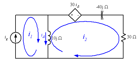

Find the average power dissipated in the 30 Ω resistor in the circuit seen in the figure if ig=7cos20,000tA.
KVL/KCL equations
P=VI* (possibly) or I^2(R)
I tried to do a mesh, but got I(60-j130) = 0, which isn't right . . . I'm assuming I find the current through the resistor and just do I^2(R)?

I don't see the controlled voltage source in there, and I don't see a contribution from the independent current source ig from the first mesh. What are your mesh equations?
That was my one mesh equation . . .

But there are two loops...
But wouldn't the other one just be Ig? Or is it 5mH(I-Ig) = 0? Converting mH to ohms of course
Well, you can call it ig if you wish, but it's still a separate mesh current.
In the figure, i1 = ig and iΔ is the net current through the inductor.
Right right. So across the inductor, it'd be (I1 - I)10j = 0? And then for the other mesh, 30I(-j40) + 30I(30) - I(j10) = 0?

No, I is the net current through the inductor. The first mesh is already "solved" for its current since it's identical to that of the fixed source. Thus ##i_\Delta = i_g - i_2##.
Remember that there are two mesh currents flowing through the inductor. And the source is dependent on ##I_\Delta##, not I.
Wait, you are very confusing right now.
So I = Ig - I2? Ok, I can dig that.
So for my other mesh, do I replace I with I2? And solve for I2?

What current is flowing through the resistor? It's ##i_2##, right? So that's what you need to find. That's the mesh current for the second loop. ##i_\Delta## is just the net current through the inductor, and happens to be the "sense current" controlling the dependent source. You don't necessarily have to solve for it explicitly, but you do need to replace it with its equivalent in terms of mesh currents otherwise you'll have another variable on your hands.The first mesh current is effectively already solved for since it's identical to ##i_g##. You don't need to write a mesh equation for it. But you do need to use the auxiliary equation for ##I_\Delta## since that's needed to write the equation for the second loop (for the controlled source).

Yup. You've got (Ig - I2) flowing through all the components. It doesn't. I2 is the mesh current that flows through all the components of the loop (with Ig flowing through the inductor too, of course, since it's a component shared by the two loops).

I∆ is a parameter of the dependent source. I2 flows through it (and through the capacitor, and through the resistor). The inductor has two mesh currents because it borders two meshes.

You've left out the impedance of the inductor, and the current through the inductor totals ##i_\Delta##, which is (Ig - I2).
You keep treating ##i_\Delta## as though it were a mesh current. It is not. It's the sum of two mesh currents. It just happens to be what they've called that sum, and is used as a parameter for the dependent source.
When you write a mesh equation, just use the mesh currents first. Then go back and make appropriate substitutions for defined parameters. That should help to avoid confusion.
I2(-j40) + I2(30) - (Ig - I2)(j10) = 0?

You're only missing the dependent source now...
I2(-j40) + I2(30) - (Ig - I2)(j10) + 30(Ig - I2) = 0?

Looks reasonable. So what's your final result?
  • #31
(j30)I = (210 - j70)
I = -2.333 - 7j
I = 7.3786 A
Arms = 5.2175 A
P = 816.66 W

Jesus thank you. Two pages of trying to figure out a simple mesh . . . Ugh . . .But 817 W is correct! Try number 1, 80% total on the homework.
