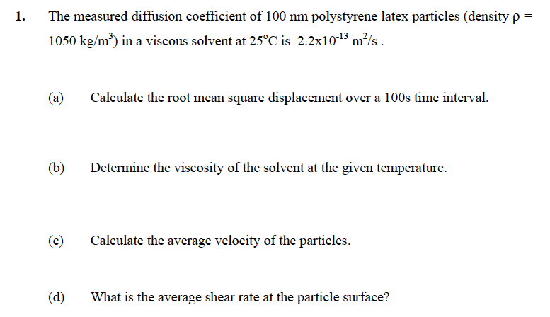

Diffusion coefficient (D) of 100 nm particles ( density = 1050 kg/m3) in a viscous solvent at 25 C is 2.2 x 10-13 m3/s
What is the average shear rate at the particle surface?

Hi Chet, This is the full question
Thanks

If I understand correctly, you have completed parts a, b, and c, and now you want want to determine the answer to part d, correct? If so, what was your answer to part c.
Chet
Likes hizen_14
Hi Chet !
Yes you are right I have done part a-c. My answer on C was 0.05 m/s
Thanks
Zen
