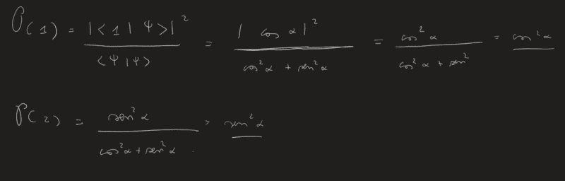

1. Determine the possible outcomes of an energy measurement and the related probabilities as a function of the real alpha and beta parameters.
Solution:
I applied the fourth postulate in the specific case with discrete eigenvalues and without degeneracy. I got:
it's right?

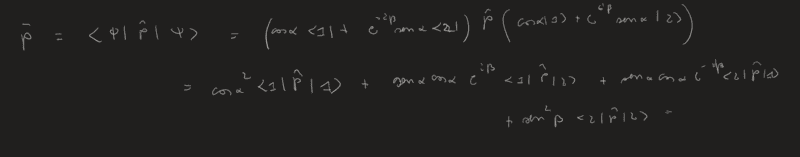

2. Determine the average value of the impulse as the parameters vary.
Solution:
In this case I don't really know how to proceed and in general in these cases I don't know how to proceed (when it comes to average values in general). I found:
At this point I should consider that the impulse p=(h/2*pi)*k. And since I know k of the different eigenstates I can find:
And continue in this way? But my reasoning seems very forced, I don't know. I'm doing it wrong?

For solution 1:
$$P(1) = \frac {|\langle1|\psi\rangle|^2} {\langle\psi|\psi\rangle} = \frac {|\cos\alpha|^2} {cos^2\alpha + sin^2\alpha} = cos^2\alpha$$
and
$$P(2) = \frac {|\langle2|\psi\rangle|^2} {\langle\psi|\psi\rangle} = \frac {|\sin\alpha|^2} {cos^2\alpha + sin^2\alpha} = sin^2\alpha$$
For solution 2:
$$\bar p = \langle\psi|\hat P | \psi\rangle = (cos\alpha\langle1| + e^{-i\beta}sin\alpha\langle2|)\hat P(cos\alpha|1\rangle + e^{-i\beta}sin\alpha|2\rangle) =$$ $$= cos^2\alpha \langle 1|\hat P|1\rangle + sin\alpha cos\alpha e^{i\beta} \langle 1|\hat P|2\rangle + sin\alpha cos\alpha e^{-i\beta} \langle 2| \hat P |1\rangle + sin^2\alpha \langle 2|\hat P |2 \rangle $$

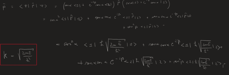

Finally I replace:
$$\hat P = \hbar k = \hbar \sqrt{\frac {2m\hat E} {\hbar^2}} $$
So, if what I wrote is right, I continue the exercise. So, with ##n## and ##m## representing stationary states ##1## and ##2## in each combination, i need:
$$\sqrt{2m} \space \langle n| \sqrt{\hat H} |m \rangle$$
At this point I consider the fact that the Hamiltonian in the basis of its eigenkets is represented by a diagonal matrix with its eigenvalues on the diagonal. So, the non-null values are:
$$\langle 1| \sqrt{\hat H} |1 \rangle = \sqrt{E_{1}} \langle 1|1 \rangle = \sqrt{E_{1}}$$ e
$$\langle 2| \sqrt{\hat H} |2 \rangle = \sqrt{E_{2}} \langle 2|2 \rangle = \sqrt{E_{2}}$$

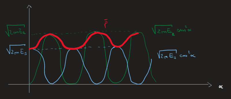

$$\bar p = \langle \psi| \hat P |\psi \rangle = cos^2 \alpha \sqrt{2m E_{1}} + sin^2 \alpha \sqrt{2m E_{2}}$$
In this relationship ##E_{1}## and ##E_{2}## have values that vary as the width ##a## of the hole varies. We represent graphically how the average value of the impulse varies as the ##\alpha## parameter varies:
Obviously considering that ##E_{2}>E_{1}##. If its's ok let me now :)
