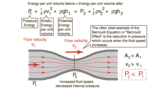

Thanks so much, I now understand. I watched some videos and found this helpful diagram:
But I don't see how to get the average pressure(ΔP) from Bernoulli's?
I don’t understand your question.

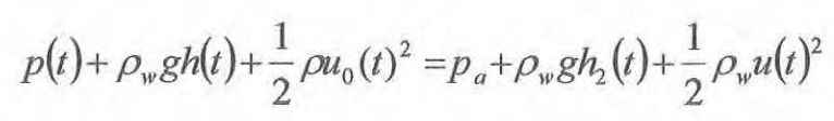

How do I get from this:
to this

Then I'll give you some hints.
We are applying Bernoulli’s equation to the water stream as it goes from a point just inside the rocket to a point just outside.
The first term on each side of the first equation refers to the pressure at a point in the stream flow. What does ##\Delta P## mean in the other equation?
The middle term on each side of the first equation refers to a height at a point in the stream flow. In the actual question, what is the change in height?
The last term each side refers to a velocity. What do we know about the velocities of the water flow at the two points (relative to the rocket)?
