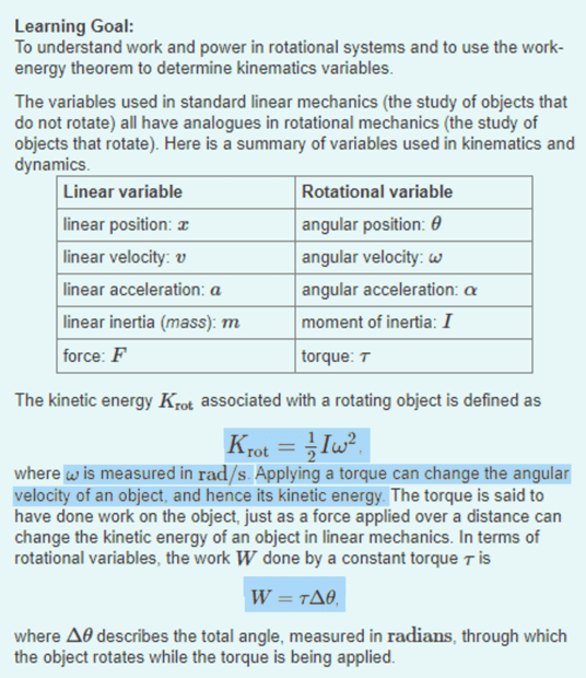

Consider a motor that exerts a constant torque of 25.0 N⋅m to a horizontal platform whose moment of inertia is 50.0 kg⋅m^2. Assume that the platform is initially at rest and the torque is applied for 12.0 rotations. Neglect friction.
What is the average power Pavg delivered by the motor in the situation above? Enter your answer in watts to three significant figures.
K = (1/2)Iw^2
W = τΔθ
P = W/Δt

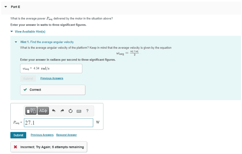

Now I'm being asked...
What is the average power Pavg delivered by the motor in the situation above?​
I assumed to find average power I would need average work, especially because the question's hint prompted me to find the average angular velocity, which it confirmed to be 4.34 rad/s. So I did the following calculations:
27.1 W was not accepted as the answer. Any advice on adjustments to make to my equation? Is there a rounding error?

I'm not sure how P differs from Pavg. According to one website I just found, "average power as the total energy consumed divided by the total time taken". Would this be accurate?
If so, would doing the calculation as...
Pavg = W tot/Δttot = 1884.95559 J / 17.36646 s = 108.54 W​
(using unrounded versions of earlier values) and then rounding to 3 sig figs (109 W) be the right way to set up and solve the equation according to the above definition?
