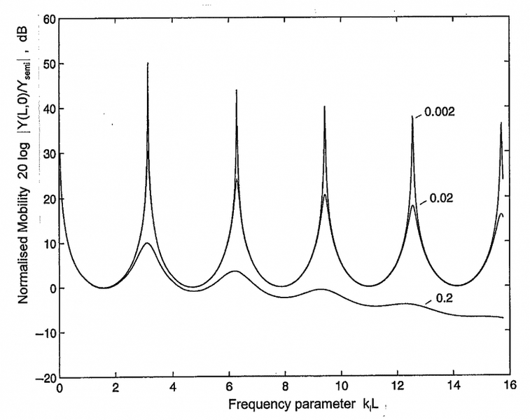

Another question emerges, however. If I am interested in the "steady state solution", for example in the case of the point harmonic force. That is, in case the initial conditions are not known and/or not of interest, how would the procedure then be?
Can you explain what you mean exactly by "steady state solution" in this context?
Likes Runei
Sure!
It would be how the solution looked if an infinite amount of time had passed.
The idea is that, if we excite one end of the beam with a harmonic point for, for example we might want to know the amplitude of displacement at the other end of the beam. So in other words - finding the Frequency Response of the system.
This is an example from the horrible, horrible, horrendous book that I've have been handed!
Here they have added a damping by making the Youngs Modulus a complex number, but the basic idea is that there will be resonant frequencies in the structure.
My question were regarding how one would go from this eigenfunction-based solution to the wave-equation, and get to a description of these resonant frequencies.
Thanks for the information.
It depends on the precise boundary conditions (in particular: the harmonic point force at one end), but I would start by carefully writing out (for a particular choice of BC at ##x = 0## and point forcing at the other end) what the system of ODEs exactly looks like. Most likely you get an infinite system of harmonically driven (harmonic) oscillators, each of which has its own separate resonance frequency. The infinite sequence that you thus obtain then corresponds to the sequence of peaks that you see in your graph. In other words: depending on the frequency with which you drive the system at one end, you will excite one of the available modes.
Of course, the above is just a qualitative sketch. To see what really happens to the ##n##th mode as you drive the system, you need to write down the corresponding ODE.
Just out of curiosity, what book are you using?
Likes Runei

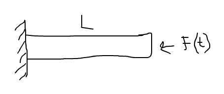

Okay, I've gone and done some work now, and I think I'm starting to get an overview of this thing.
There's a few kinks however - But here goes. The system I'm using as an example is the following:
So the boundary conditions are: ##\Psi(0,t) = 0## and the first derivative ##\Psi^{(1)}(L,t) = -\frac{1}{EA}F(t)##.
The condition at L comes from the relationship between force, stress and strain.
$$\frac{\partial^2\Psi}{\partial t^2} - c^2\frac{\partial^2\Psi}{\partial x^2} = 0 $$
Since we are dealing with in-homogeneous boundary conditions we look for a solution of the type:
$$\Psi(x,t) = \Psi_i(x,t) + \Psi_h(x,t) $$
Here the subscript "i" expresses the fact that the function satisfies the inhomogeneous boundary conditions, and "h" satisfies the homogeneous boundary conditions.
$$\Psi_i(x,t) = - \frac{L}{EA\pi}F(t)sin(x\pi/L) $$
This function satisfies the boundary conditions. When we insert this into the differential equation we get:
$$\frac{\partial^2\Psi_h}{\partial t^2}-c^2\frac{\partial^2\Psi_h}{\partial x^2} = c^2\frac{\partial^2\Psi_i}{\partial x^2}-\frac{\partial^2\Psi_i}{\partial t^2}$$
The function on the RHS is a known function (because we solved the boundaries), so we can say that it is a function ##q(x,t)##.
Next we solve this PDE by using the eigenfunctions/modes of the system. The boundary conditions for this system are homogeneous and ##\Psi_h(0,t) = 0## and the first derivative ##\Psi_h^{(1)}(L,t) = 0##.
These boundary conditions lead to eigenfunctions of the form: ##\psi_n(x) = \sin(\frac{2n-1}{L}\frac{\pi}{2}x)##, and we call the spatial wave numbers ##k_n##.
So the function ##\Psi_h(x,t)## can be written as an eigenfunction-expansion of the form
$$ \Psi_h(x,t) = \sum\limits_n \tau_n(t)\psi_n(x) $$
Here the functions ##\tau_n(t)## are the time varying expansion coefficients. The eigenfunctions can be arbitrarily scaled to have a norm (over the domain) of 1. This fact is used when the next step is taken - insert the expansion sum into the differential equation, multiply from the left by a given eigenfunction ##\psi_m(x)## and integrate over the domain. Because of the orthogonality between eigenfunctions and the norm of 1 - we end up with the following:
$$\ddot\tau_m(t) - c^2k_m^2\tau_m(t) = \int\limits_0^L\psi_m(x)q(x,t)dx$$.
The term on the RHS is a function only of t, and is equal to the Fourier coefficient of the function q(x,t) in this domain. Also, the whole system is a second order ODE, which can be solved with relevant techniques (for example Laplace). But it of course depends on the function q(x,t). But in our case, it is assumed that we know it (because we know F(t) ).
Great. I can do one more step: If we assume that the force F(t) is harmonic and given by the function ##F(t) = F_0 sin(\omega t)##, we can insert this into the relevant places. First of all, we know have a specific knowledge of the function q(x,t), because now we have:
$$\Psi_i(x,t) = -\frac{LF_0}{EA\pi}\sin(\omega t)\sin(\frac{x\pi}{L})$$
$$q(x,t) = c^2\frac{\partial^2\Psi_i}{\partial x^2}-\frac{\partial^2\Psi_i}{\partial t^2} = (-c^2\frac{\pi^2}{L^2}+\omega^2)\Psi_i(x,t)$$
So we can calculate the integral that gives us the RHS in the ODE for ##\tau(t)##.
$$\int\limits_0^L\psi_m(x)(\omega^2-c^2\frac{\pi^2}{L^2})\frac{LF_0}{EA\pi}\sin(\omega t)\sin(\frac{x\pi}{L})dx$$
$$ = (\omega^2-c^2\frac{\pi^2}{L^2})\frac{LF_0}{EA\pi}\sin(\omega t)\int\limits_0^L\sin(\frac{2n-1}{L}\frac{\pi}{2}x)\sin(\frac{x\pi}{L})dx $$
And let me stop it here. The idea is then to solve the integral(s) (one for each mode) - then solve the ODE for tau, which gives all the expansion coefficients for the homogeneous equation ##\Psi_h(x,t)##. Finally - the particular and complementary solutions are added together to give the full solution.
Phew. Did I make any grievous mistakes? I had hoped the integral looked a bit nicer...
Up to a minus sign at ##x = L## since ##D_x\Psi_i(L,t) = \frac{F(t)}{EA}##.
Correct, and it is good to keep in mind that ##n = 1,2,\ldots## with ##k_n := \frac{(2n-1)\pi}{2L}## and eigenvalues ##\lambda_n = k_n^2##, where the eigenvalue problem read
\psi''(x) + \lambda\psi(x) = 0, \qquad \psi(0) = 0,\, \psi'(L) = 0 \qquad (1)
The idea is now, very roughly, that every function on ##[0,L]## that is sufficiently well-behaved and satisfies the homogeneous boundary conditions can be written as an expansion in terms of the ##\psi_n## and differentiated term-by-term.

\ddot\tau_m(t) - c^2k_m^2\tau_m(t) = \int\limits_0^L\psi_m(x)q(x,t)dx.
Almost. I don't agree with the minus sign on the left, it should be a "+" I believe. To check this, it is easiest to use (1). It also makes sense, because we expect to end up with an ODE that describes a harmonic oscillator, so the term with ##\tau_m## should appear as positive on the left.
\int\limits_0^L\psi_m(x)(\omega^2-c^2\frac{\pi^2}{L^2})\frac{LF_0}{EA\pi}\sin(\omega t)\sin(\frac{x\pi}{L})dx\\
I think in both lines there is a multiplicative factor ##-1## missing. In the second line the ##n## in the integrand should be ##m##.
Exactly.
No, as far as I can see you did well! Using Maple, I managed to evaluate the last integral a bit further to get
\int\limits_0^L\sin(\frac{(2m-1)\pi x}{2L})\sin(\frac{x\pi}{L})dx =\frac{(-1)^m4 L}{(4m(m-1) -3)\pi}
which looks somewhat nicer.
Sorry for taking some time to respond.
Likes Runei
Thanks Krylov!
I think you're right about the minus sign. Algebra mistake I guess.
I went to the exam and it went very well! So a great many thanks for the help to you and also Orodruin!
My exam question was actually bending waves instead of longitudinal waves, but the help you've provided here with the PDEs have been great at giving me a good understanding of the topics involved.
So thanks again :-)
