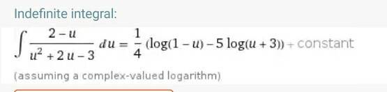

what next?
integrate both sides
but what is the advantage of the factored denominator?
RHS
https://www.physicsforums.com/attachments/10197
wow
method of partial fractions
$\dfrac{2-u}{(u+3)(u-1)} \, du = \dfrac{dx}{x}$
$\dfrac{2-u}{(u+3)(u-1)} = \dfrac{A}{u+3} + \dfrac{B}{u-1}$
$2-u = A(u-1) + B(u+3)$
$u = 1 \implies B = \dfrac{1}{4}$, $u = -3 \implies A = -\dfrac{5}{4}$
$\dfrac{1}{u-1} - \dfrac{5}{u+3} \, du = \dfrac{4}{x} \, dx$
$\ln\left|\dfrac{u-1}{(u+3)^5}\right| = 4\ln|cx|$
$\left| \dfrac{\frac{y}{x} - 1}{\left(\frac{y}{x}+3\right)^5} \right| = cx^4$
$\left|\frac{y}{x} - 1\right| = cx^4\left|\frac{y}{x} +3\right|^5$
$x \left|\frac{y}{x} - 1\right| = cx^5\left|\frac{y}{x} +3 \right|^5$
$\left| y-x \right| = c\left|y +3x \right|^5$
