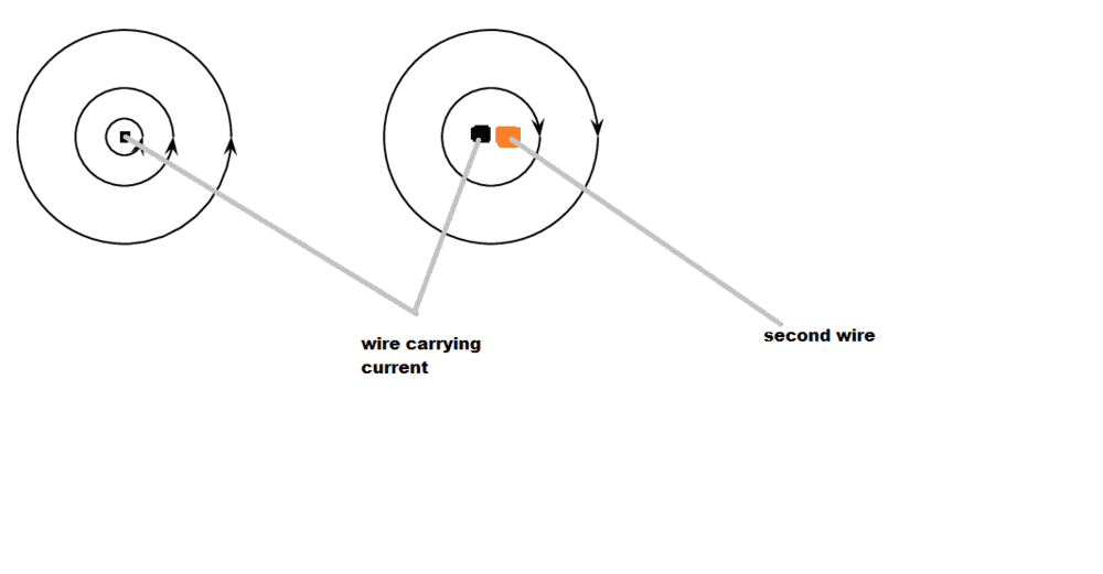

A quick description. A single straight wire and a second straight wire, both wires are electrically as well as physically separated, the physical separation distance assume is very small in order for the B field experienced by the second wire to be sufficiently strong.
In all cases one of the wires is connected to a power supply and has current in it the other wire is connected to a test meter for current and voltage.
Here is what I want to understand. When current flows through a wire there is a B field around the wire commonly shown as an arrow forming a loop around the wire, what happens when I place a conducting object at any point next to the wire , does in theory the B field experienced by that conducting object (a piece of conducting foil for example) is cutting the object at 90 degrees and can be said to be perpendicular to it?
I've attached a picture with a drawing which is made such that (you) the observer is looking from the top of the wire end.
So if a DC current passes through the first wire a static B field is set around it and this B field penetrates as well as loops around the second adjacent wire (shown in orange) , I wonder what happens with AC, especially high frequency all the way up to RF?
I would expect that as the frequency increases the field penetration depth decreases , what happens now? Can we still say the B field is cutting the second wire/conductor perpendicularly or is it now looping entirely around it due to induced surface eddy currents in the second wire/conductor?
No. There is no requirement that the B field be perpendicular to a wire. In the case you have described the field is perpendicular to the “passive” wire, but that is dictated by your setup and not the laws of EM.
You don’t get substantial eddy currents in thin structures, you would need a sheet rather than a wire.
Well my bad I wrote it wrong.
I was basically asking at what angle would the B field that is around a current carrying wire cut another wire located adjacent to the current carrying one, and from what I see in your answer the field would cut the second "passive" wire mostly perpendicularly to its surface.
So a single straight wire can also produce a B field that cuts an adjacent conductor much like that which would come out of the end of a electromagnet coil?
