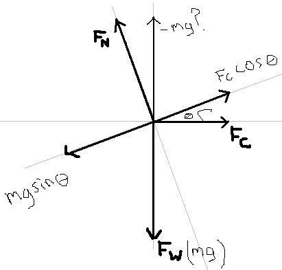

normal force something like Fn = -mg/cosx
okay that's my crappy diagram and might help you explain to me where I am going wrong
You shouldn't have the (-mg?) force. Part of the weight will be down the ramp... as you've indicated by the component (mg sin theta), and part of the weight (a component you are missing on your diagram) will press into the carrier and be supported by the normal force.
In your diagram, you've left out the friction force, which relates to the normal force, which you could find by clear indication of components.
Furthermore, if you're going to take a force (like the weight) in your free body diagram and replace it with components, be SURE you do this throughly, and then I suggest you mark it out in some noticeable way (texts tend to put a squiggle through it, but you could also "x" it out).
You left out the friction force. Don't add extraneous stuff, like components. (Or -mg... what's that??)
You should just have: Normal force; weight; friction force.
Don't put Fc on a free body diagram. You'll get to that when you apply Newton's 2nd law.
Edit: As physics girl phd says, be careful to distinguish components from the original vector if you want to put them on the diagram. Otherwise you might end up counting a force twice.
