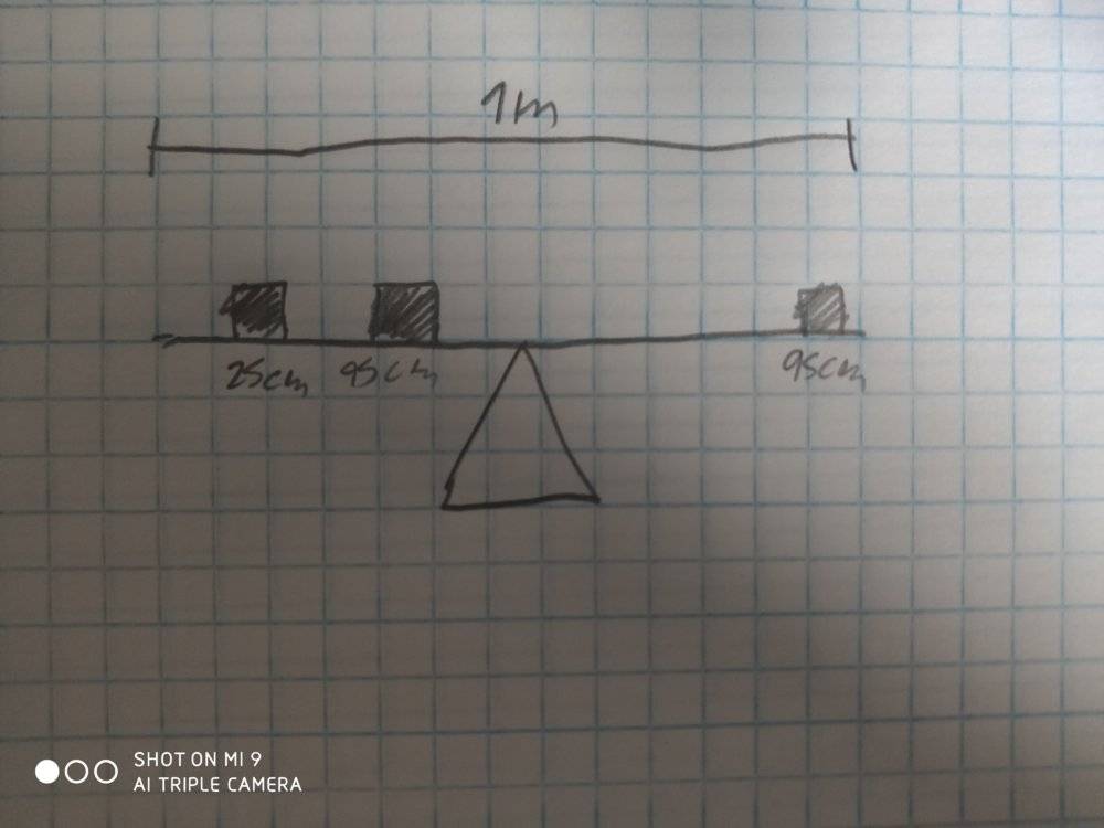

I assume is like the draw below.
Can you explain me how you get to the answer please?
I think too they give the measurements from left to right of the rod

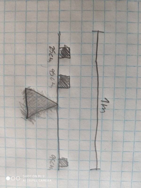

It's the graphic correct?
It's a little hard to read because it's sideways, but otherwise it's a good start. Now add lines from the center fulcrum out to each of the 3 weight positions, and label those lines with the distance to each from the center. Then write the equation that shows the sum of those 3 torques about the center fulcrum. Thanks.

There is where I have trouble. The problem say one weight is at 95cm but not say from what and It couldn't be from the center because the rod is 1m long. Cold be at 45cm if I substract 95 from the center that is 50. That would be right?
I make it again with other perspective. Does the answer is 15cm?
You have a balanced 100 cm bar.
Fulcrum is located at middle point: 50 cm from left end and 50 cm from right end.
Why is that location important?
Mass 1 is located 25 cm from left end and 100-25=75 cm from right end, how far from fulcrum? Let's call that distance X1.
Mass 2 is located 45 cm from left end and 100-45=55 cm from right end, how far from fulcrum? Let's call that distance X2.
Mass 3 is located 95 cm from left end and 100-95=5 cm from right end, how far from fulcrum? Let's call that distance X3.
Mass 4 is located A cm from left end and 100-A=B cm from right end, how far from fulcrum? Let's call that distance X4.

I think I got it. Is 35cm
Using net torque equation
(0.25)(9.8)+(0.05)(9.8)+(x)(9.8)-(0.45)(9.8)=0
The answer of that is 15cm from the center but the problem give me distance from left to right so 50-15=35cm
How can you have 3 weights on the left of the fulcrum balancing one weight on the right of the fulcrum? Can you post your final diagram with unambiguous distances labeled please? Thanks.
You did it! :cool: :cool: :cool:
The formula: You need to add "m" between "g" and each lever distance.
I think it could be because the weight on the left side are very close to the center, that means less down force, and the weight on the right side is very far from the center. So I think it's possible to have 3 weight on one side. The final distance are 25, 35, 45 and 95cm. Can you explain me why that isn't the answer?
Please post your final drawing with distanced labeled from the center, and your final sum of torques (typed into the forum). Thanks.
