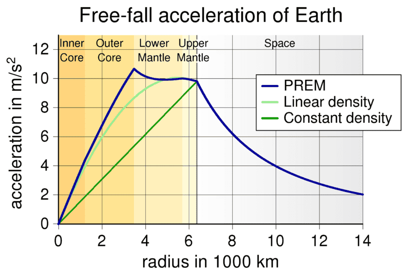

As you get deeper, you will have to consider the diminishing value of g, as more and more of the Earth is above the ball and thus cancels out.
My calculations stated that the ball had only fallen 1% of the Earths radius after 2 minutes, so I ignored that also. I'm guessing that's why I stopped there, as, damn, I got yard work to do. Fall is coming, and that's a whole lotta maths.

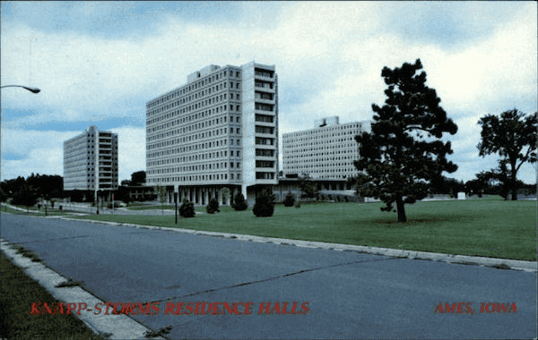

100 meters is a 30 story building or thereabouts. Where I matriculated, our physics building was only two or three stories high. I roomed in a dormitory which was 129 feet high at the top of the enclosures above the elevator shafts. Ten stories. Call it 40 meters.
At that height, one would expect a deflection of only 5.5 millimeters.
