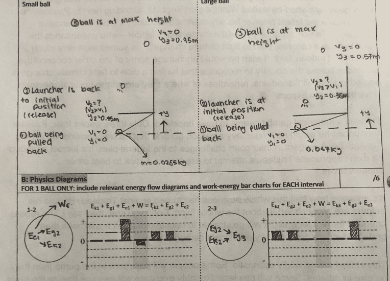

So, we've been shown a video in which a ball in launched and we were required to make sketches with all the data given in this video (launch height, ball mass etc.) Then we were asked to determine which ball lost more energy. I completed my mathematical solution but my teacher said "Good up to this point, however this one step remaining". I've been trying to figure it out for superrr long but I'm not sure. Ive attached the sketch of what is going on so you have all the data.
Energy equations

The video is a different one that shows the same thing but with two different balls (a big ball and a small ball) and the question is which of the two balls loses more initial elastic energy. And we have to determine this mathematically using energy equations.
The masses are given in the physics sketch too one ball is 0.0285 kg and the other is 0.067 kg
