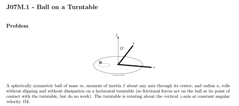

A spherical ball of mass “m”, moment of inertia “I” about any axis through its center, and radius “a”, rolls without slipping and without dissipation on a horizontal turntable (of radius “r”) describe the balls motion in terms of (x,y) for a function of time.
**The turntable is rotating about the vertical z-axis at a constant unspecified angular velocity.
**Radius and mass of the turntable and the ball are unspecified.
Can someone please show me step by step how to solve this problem?

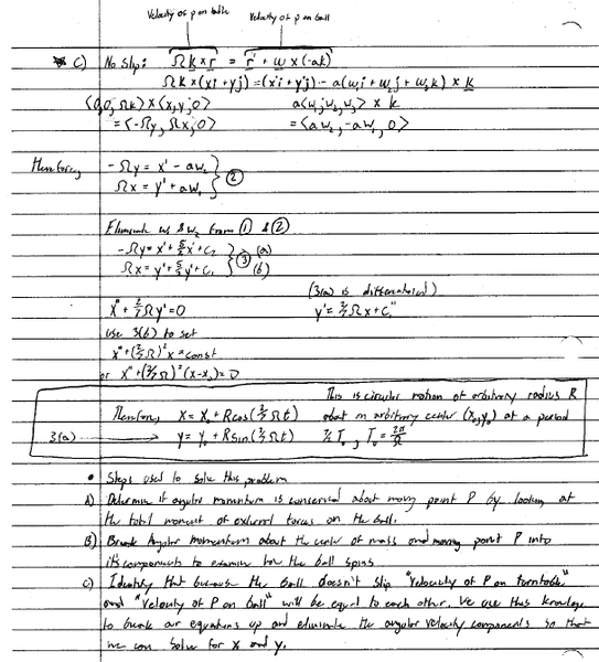

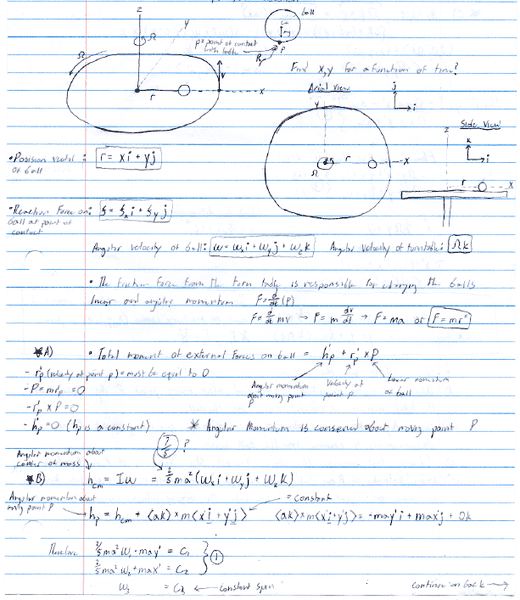

Here's my work in text format:
In part A
of my work I determined that angular momentum is conserved about the moving point P. (Point P being the point on the ball in contact with the turntable.) If I'm not mistaken that would mean that the angular momentum at moving point P is coupled to that of the turntable.
In part B I broke the angular momentum into its components to examine how the ball spins:
(angular momentum at Center of Mass)=(moment of inertia of a ball)*(angular velocity) or
hcm=IW
ν= (2/5)ma^2*<wxi + wyj + wzk> (angular momentum at Point P)=(angular momentum at Center of Mass)+(Radius “a”) cross product (linear momentum)
hp= hcm+ a x p
= hcm + a x mv
= hcm + a x m<vxi + vyj>
= hcm + <-mavyi + mavxj>Therefore,
(2/5)ma^2*wx - mavy = C1 C=constant
(2/5)ma^2*wy + mavx = C2
Wz=C3In part C I acknowledged that because the ball doesn’t slip “The velocity of point P on the turntable” and the “velocity of point P on the ball” will be equal to each other. I used this knowledge to break up the equation and eliminate the angular velocity components so that we can solve for x and y positions
Ωk x r = v + w (cross product) (-ak) Ωk= constant rotation about the z axis
My final answer was:
x=xo + RCos((2/7)Ωt)
y=yo + RSin((2/7)Ωt)
This is my attempt at solving the problem, but my professor has told me it's wrong. Can you please show me how you would solve it and what answer you get. Thank you :)
