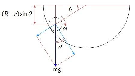

Ball of mass m and radius r rolls without sliding in a bowl of radius R.
Express it's angular velocity ω as a function of the angle θ.
What are the normal force and friction force as a function of θ.

The descending in height is transferred to kinetic energy:
$$mg(R-r)\sin\theta=\frac{1}{2}\left( \frac{2}{5}mr^2+mr^2 \right)\omega^2\;\rightarrow\; \omega^2=\frac{10}{7}\frac{R-r}{r^2}g\sin\theta$$
$$\omega=\left( \frac{1}{r}\sqrt{\frac{10}{7}g(R-r)} \right) \cdot (\sin\theta)^{\frac{1}{2}}$$
$$\dot\omega=\left( \frac{1}{2r}\sqrt{\frac{10}{7}g(R-r)} \right) \frac{\cos\theta}{\sqrt{\sin\theta}}$$
The normal force is the substarction of the weight's radial component and the centripetal one:
$$F=mg\sin\theta-\frac{1}{2}I\omega^2=mg\sin\theta-\frac{10}{7}\frac{R-r}{r^2}g\sin\theta=mg\sin\theta\left( \frac{10}{7}\frac{R-r}{r}+1 \right)$$

I don't see the connection between the centripetal force and ##-\frac 12 I\omega^2##. I count four things wrong there.
$$F=mg\sin\theta-mr\omega^2=mg\sin\theta-\frac{2}{5}mr^2\cdot \frac{10}{7}\frac{R-r}{r^2}g\sin\theta=mg\sin\theta\left(1+ \frac{4}{7}\frac{R-r}{r} \right)$$
Karol said:
##-mr\omega^2##
That fixed two problems, two to go.
Remember that the centripetal force is a component of the resultant of the actual forces. In fact, it is better to renounce the concept of centripetal force and think instead in terms of centripetal acceleration.
To make sure the signs are right, get into the habit of writing such equations in the standard Fnet=ma form, where the net force is the resultant of the actual forces.
The other problem concerns the (angular) velocity and radius of the centripetal acceleration. Where is the centre of curvature of the trajectory of the ball's centre?
$$F=m(R-r)\omega^2-mg\sin\theta=m(R-r)\cdot \frac{10}{7}\frac{R-r}{r^2}g\sin\theta-mg\sin\theta=mg\sin\theta\left(1+ \frac{10}{7}\left( \frac{R-r}{r} \right)^2 \right)$$
Still not right.
I assume you are taking g to have a positive value. If F is the normal force, what is the net radial force on the ball?
Also, you are confusing ##\omega## with ##\dot\theta##.
$$F=m\frac{v^2}{R-r}+mg\sin\theta=\frac{m}{R-r}\omega^2r^2+mg\sin\theta=\frac{m}{R-r}\cdot \frac{10}{7}\frac{R-r}{r^2}g\sin\theta r^2+mg\sin\theta=mg\sin\theta\left(1+ \frac{10}{7} \right)$$
Yes, that looks right.
