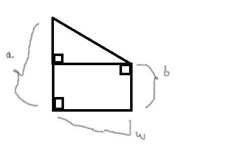

The displacement is the area under the line ... that shape is a trapezium, what is the formula for the area of a trapezium?
(If you do not know, divide the area into a rectangle and a triangle and do it that way.)

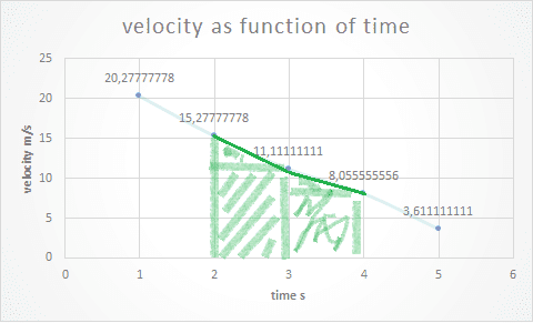

1.)Apparently one source of my confusion is the justification for the [(V_0 + V_1)/2] * Δt.
Actually the entire displacemnt formulas are rather confusing.
Hopefully they have been explained above ... they are the formulas for the area under the v-t graph between the times of interest. All you need to know how to do is how to sketch these graphs from a description, and remember the formulas for simple areas. later you will learn calculus, which will make the relationships even more plain.
2.)Why did the formula only have the component values as the fraction terms ...
... same answer as above.
It's geometry.

By definition, the displacement is the area under the v-t graph (in maths: ##s=\int_0^t v(t')\;dt'##)
a. the area is a trapezium: the formula for a trapezium with parallel sides length a and b separated by width w is ##A=\frac{1}{2}(a+b)w##
... so ##s=\frac{1}{2}(v+u)t## ...call this eq(2)
b. the area is a triangle, height v-u and base t, on top of a rectangle of height u and base t:
... so: ##s = \frac{1}{2}t(v-u) + ut##. Prove that this is the same as (2)

I think the picture about the displacement as area under the line makes more sense in triangle and a box.
I did do another problem with graphing like that with the same strategy. The scenario in that other problem was a straightforward situation of a car braking scenario with the car's velocities written out together with time.
The objective was to find the total displacement in the time interval from 2s -->4s. I think this was easy for me because the car is only moving straight forward even though it is braking at the same time.
the values which existed were tabulated as
it comes out such that we can calculate each displacement which was during one second. And add those displacements together.
I think it comes out as a graphical integration when you put the velocity into y-axis and time into x-axis.
The catch of that exercise was to notice that acceleratino was not constant across that interval because the line is a little bit crooked for velocity. So appparently you have to essentially calculate like two different trapezium and their area together forms the displacement. It looks like the answer to that was about 22.78m

I suppose enough proof will be to work from triangular definition and work the example of the box area, plus the triangle area. into the trapezium formula. ?
I will first go from trapezium variables and try to see if that works also for the physics variables like ##V_0## and ##V_1## ##t##etc...
##\frac{1}{2}*(a+b)*w##
triangle area is good and clear ##\frac{(a-b)*w}{2}##
box area is good and clear ##b*w##
expand box fraction
##\frac{bw}{1}+\frac{(a-b)*w}{2}##
##\frac{2bw}{2}+\frac{(a-b)*w}{2}##
##\frac{2bw+aw-bw}{2}##
factorize
##\frac{aw+bw}{2}##
##\frac{(a+b)*w}{2}##
##\frac{(a+b)}{2}*\frac{w}{1}##
##\frac{1}{2}*(a+b)*w##for the displacement equation with physics variables. Unless I have made grave error in interpreting your variables. I will write the variables equally validly as follows.
That is correct ... there was only motion in 1 direction, so you choose that direction for the +x axis and go from there.
...it comes out such that we can calculate each displacement which was during one second. And add those displacements together.
Finding the area under a graph is, indeed, integration... but we don't like to do calculus if we can avoid it - like when the shapes are simple.
However, try to get out of thinking of x and y axes when you are not using them for x and y. They are "horizontal" and "vertical" axes until they are assigned to something, and when the vertical is velocity then it becomes "the velocity axis" ... but there is no special reason to assign a particular thing to a particular axis besides convenience. I sometimes make say "y=<distance fallen>" then the vertical axis will actually indicate distance downwards and get labelled "y". There are also situations where it may be more convenient to plot y values on the horizontal axis (common in relativity where time is on the vertical and distance is on the horizontal).
... that is the correct reasoning.

late347 said:
furthermore it looks like your equation for the displacement in this case is turned around image of my trapezium as follows...
Yep - in the general example I said that v>u, so the trapezium top has an upwards slope.
For the equation where v<u, you would write: ##s=\frac{1}{2}(u-v)t +vt##
You can also start with the big rectangle and subtract the upper-right triangle :) ##s=ut - \frac{1}{2}t(u-v)##
... it doesn't matter because the equations end up the same.
