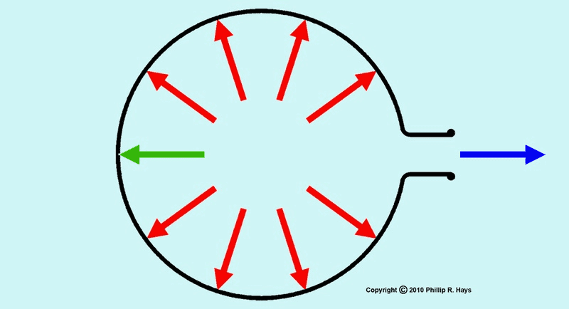

I understand that the balloon will go in the opposite direction than the air that comes out. But other than Newton's law, I can't find an explanation of why the balloon goes in the opposite direction.
The law of action and reaction is the explanation that I see everywhere. But I can't find anywhere what exactly pushes the balloon in the opposite direction as the air coming out.
Air molecules come out to where pressure is less. What exactly moves the rubber balloon in the opposite direction?
Can anyone explain this without referring to a principle?
Thank you.

For an ultra-simplistic visual explanation, let's pretend there are only ten "air molecules" in the balloon, as suggested by the diagram below.
They all push against each other to create a pressure in the balloon, pushing outward.
In the diagram, you can see eight "air molecules" pushing outward (red arrows), but they are in pairs - one opposite another. Their forces cancel out. The balloon goes nowhere.
But one molecule, blue, shoots straight out of the balloon to the right. It applies no force to the balloon.
But it also means that one molecule - out of all ten of them - the green one - has no opposing force. It pushes on the front of the balloon, giving it a shove forward.
Multiply that by a few brazillion molecules, and you have a net force toward the left.
Likes Ibix, PeroK and anorlunda

Pretty diagram. So... does the balloon distend from the green arrow poking it to the left ? Translational movement and attendant aerodynamics aside, if you were (lightly) holding the balloon, would a teepee form at the front ?
No.
Just because there's no net force in the red "air molecules" doesn't mean there's no force at all.
Every air molecule except the blue one is pushing the balloon outward with equal force. So you get a sphere, not a teepee.
