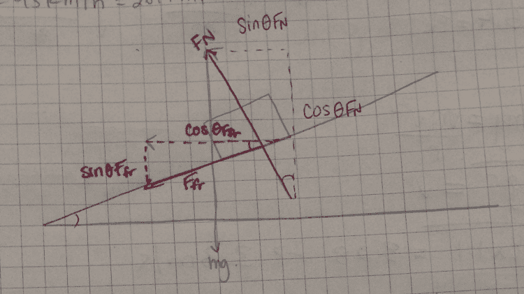

If a curve with a radius of 88m is perfectly banked for a car traveling at 75km/h, what must be the coefficient of static friction for a car not to skid when traveling at 95 km/hr
75km/h = 20.8m/s
95km/h = 26.4m/s
Fr=mv^2/r
Fr=centripetal force
m = mass
r = radius
v = velocity
Fn= normal force
Ffr= force of friction (Us*Fn)
g = gravitational acceleration
Us = coefficient of static friction
Horizontal component
sinθFn=mv^2/r Eq 1
Vertical component
cosθFn=mg
Fn=mg/cosθ Eq 2
Sub eq 2 into 1
sinθ (mg/cosθ) = mv^2/r (sinθ/cosθ = tanθ)
tanθ mg = mv^2/r
m cancels out
tanθ = v^2/gr
θ = arctan 20.8^2/9.8*88
θ = 26.6 degrees
Am I right up to there?
Now for the second part of the question. Solving for Us.
See diagram for force of friction and horizontal and vertical components
Vertical component
cosθFn - sinθFfr - mg = 0 ( there is no vertical displacement)
Solve for Fn
Fn= (sinθFfr + mg)/cosθ
sinθFn + cosθFfr = mv^2/r
Sub Fn from above
sinθ ((sinθFfr + mg)/cosθ) + cosθFfr = mv^2/r
From here I am unable to isolate Ffr, or cancel out the mass... Help!

Without going through your whole solution, one thing I noticed is that when you solve for Fn, you divided mg by cosθ, but you forgot to divide the first term by cosθ.
EDIT: Also, I don't know why you are not able to isolate Ffr.

Should be:
cosθFn = sinθFfr + mg
cosθFn/cosθ = (sinθFfr + mg)/cosθ
Fn = sinθFfr/cosθ + mg/cosθ
TomHart said:
Should be:
Ok that correcting that I get the following
sinθ (sinθFfr/cosθ + mg/cosθ) + cosθFfr = mv^2/r
=sinθtanθFfr + tanθmg + cosθFfr = mv^2/r
= Ffr(sinθtanθ + cosθ) + tanθmg = mv^2/r
Ffr = (mv^2/r - tanθmg)/(sinθtanθ+cosθ)
Even if I isolate Ffr here, m is unknown and I haven't been able to cancel it out...

$$F_n\cos \theta-F_{fr}\sin \theta=mg\tag{1}$$
$$F_n\sin \theta+F_{fr}\cos \theta = m\frac{v^2}{r}\tag{2}$$
Multiply Eqn. 1 by ##\cos \theta## and Eqn. 2 by ##\sin \theta##. Then add them together. What do you get?
Multiply Eqn. 2 by ##\cos \theta## and Eqn. 1 by ##\sin \theta##. Then subtract the result from Eqn. 1 from the result from Eqn. 2. What do you get?

MPat, I think your problem starts when you "solve for Fn". Mathematically, you did it right. But you really still have another Fn term on the right-hand side of that equation because the friction force Ffr is proportional to the normal force Fn. You should make that substitution BEFORE you solve for Fn.
@MPat
If you had followed the simple linear equation elimination approach I indicated in post #8, you would have immediately obtained:
$$F_n=mg\cos \theta+m\frac{v^2}{r}\sin \theta$$
$$F_{fr}=m\frac{v^2}{r}\cos \theta-mg\sin \theta$$

GOT IT!...answer is Us = 0.22
I confirm that (0.216).
