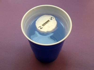

Just float it in water...
https://www.kjmagnetics.com/images/blog/water-compass400.jpg
Likes davenn, Nidum and Flyx
What if it is a horse-shoe magnet?
No
In the end all you are trying to do is create a moment to rotate the magnet, so again, if you have both poles facing the ground there will still be a torque trying to rotate the magnet...from a string!
Likes Flyx
You will still get a small torque that will align the magnet. There is an easy trick to make the torque for a horseshoe magnet much larger in the Earth's magnetic field. Can you think what that trick might be? :smile:
